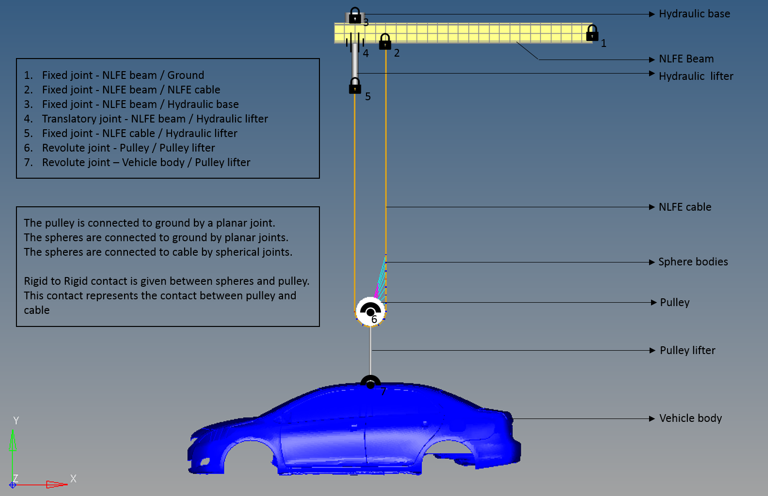

Multibody Model
The beam is modeled with a single NLFE beam of I-section. The rope is modeled using 68 NLFE cable elements. The pulley, hydraulic base, hydraulic lifter, pulley lifter and so on are modeled as rigid cylinders. There are a number of sphere bodies used to establish contact between the cable and pulley. Gravity is kept ON for this model.
The various joints between the bodies in the crane are as shown in the figure below.
Figure 1. The Crane Modeled in MotionView
