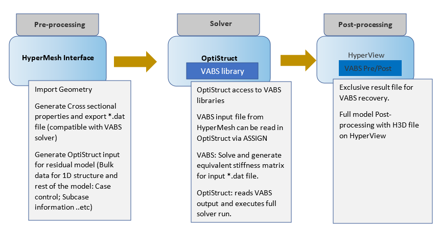

The HyperMesh interface has special utility to generate a finite element mesh of the cross section including all the details of geometry and material as inputs to calculate the sectional properties including structural properties and inertial properties. VABS compatible input file is saved at a prescribed working directory. The unified work flow further enables to generate OptiStruct input deck for the residual model in the same HyperMesh session.
With the ASSIGN command, OptiStruct identifies the VABS inputs, solves and generate equivalent stiffness matrix by invoking the VABS executable. OptiStruct further reads VABS output and executes the full solver run.
Figure 1. High Level Workflow

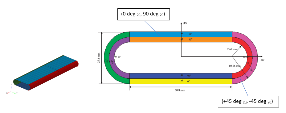

In this tutorial, a composite pipe with uniform thickness is considered. The ply sequencing and orientation are:
Figure 2. Composite Pipe
Orthotropic material with ply orientations (in degrees) as:

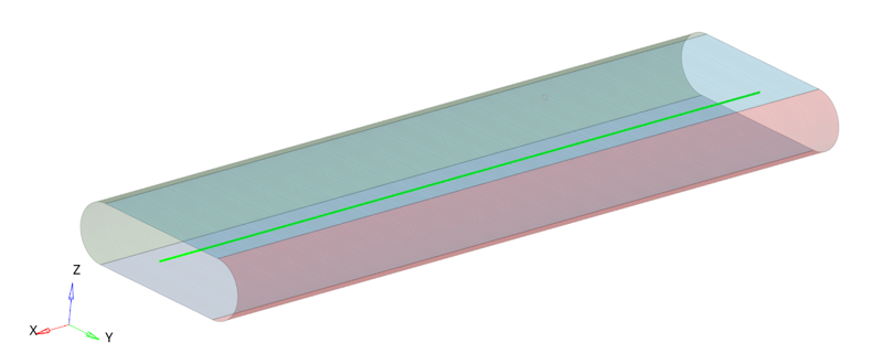

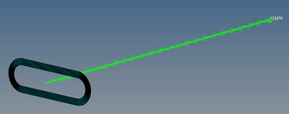

1D elements (CBEAM) are idealized along the center of the pipe, such that the beam axis is aligned to the X-axis of the pipe. A total number of 25 CBEAM elements are chosen for better convergence.
Figure 3. 1D (CBEAM) Elements Aligned with the x-axis Center of the Composite Pipe

The model shown in Figure 3 is used in this exercise. The 2D (SHELL) mesh and 1D (CBEAM) elements are already idealized.

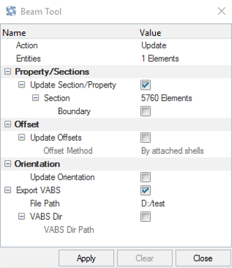

  1. Click Aerospace > Beams > Beams from lines.
    The Beam Tool dialog opens.
  2. For Action, select Update under Value from the drop-down menu.
  3. For Entities, click on the 0 Elements and then click on the yellow Elements button.
    This allows you to select elements from the panel.
  4. From the panel, click on the yellow elems button.
  5. Select by id and select any one 1D (CBEAM) element from the graphics window (choose element ID: 5761 for the exercise problem).
  6. Click Proceed.
  7. For Property/Sections, click the check box next to Update Section/Property.
  8. For Section, click in the Value field, and select Elements from the drop-down menu.
    This should enable to choose elements from the panel (similar to step above).
  9. Click on Elements > By Collector, from the panel, and select the four components which contain shell elements (pipe_top; pipe_bottom; pipe_right; pipe_left).
  10. Click Proceed.
  11. Under Export VABS, specify the location where the VABS input file (*.dat) is to be exported.
    Figure 4. Define Settings in the Beam Tool Dialog
  12. Click Apply.

    Figure 5. Visualization of the Shell Mesh at the Cross-section

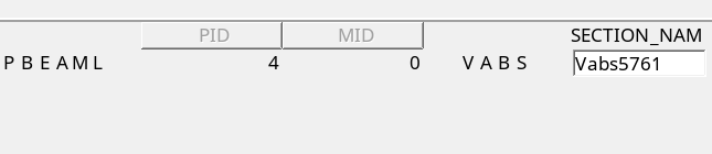

  3. Click Card Edit to review the Group and Type of the PBEAML.
    1. Verify Group is set to VABS.
    2. Type is set to Vabs5761 (suffix of the element ID of the CBEAM chosen for generating cross section).
      Figure 7. Review PBEAML VABS Property

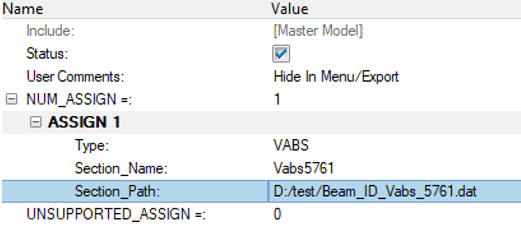

  4. In the Model Browser, expand Cards folder.
  5. Right-click on ASSIGN.
  6. In the Entity Editor, verify:
    1. Type is set to VABS.
    2. Section_Name is set to Vabs5761.
    3. Section_Path is set to the directory where the VABS input *.dat has to be exported.
      Figure 8. Review the ASSIGN Entry

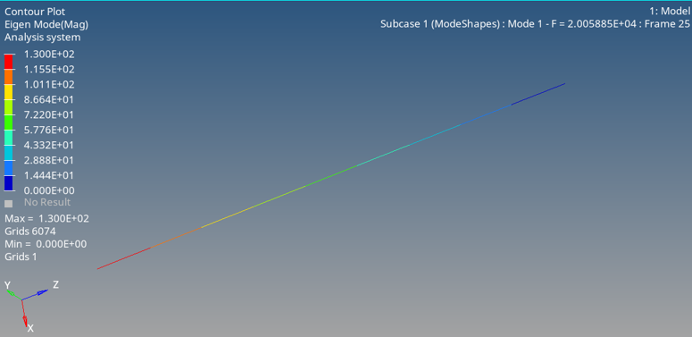

OptiStruct automatically invokes the VABS executables and runs the *.dat file to generate equivalent stiffness matrix. OptiStruct reads VABS output and executes full solver run.
  1. When the analysis process completes, click HyperView to launch the results.
  2. In the Results tab, select Subcase 1 (ModeShapes) from the subcase field.
  3. Go to the Contour panel in HyperView.
  4. For Result type, select Eigen Mode(v).
  5. Click Apply to visualize the contour plot.
    Different modes could be contoured by changing the mode number under the Subcase.
    Figure 9. Mode Shape Results in HyperView
    Unlike isotropic beams, composite beams exhibit strong coupling between various types of deformation – in this case extension-twist and bending-shear couplings, which is evident from the mode shapes.
