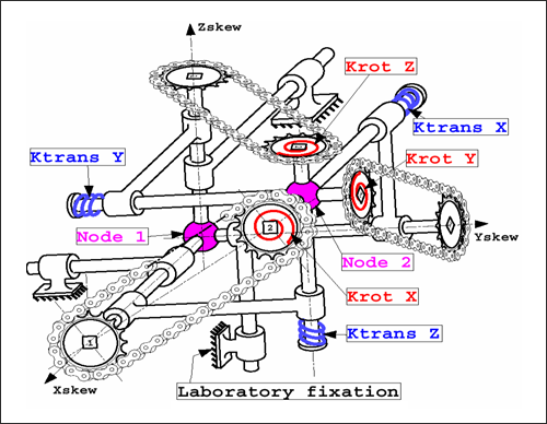

To understand the physical behavior of this mathematical spring, imagine that the two nodes of
the spring are chained together. Therefore, only the relative translation/rotation
between nodes can be considered as independent degrees of freedom. Figure 1 is a schematic
illustration. Figure 1. Spring TYPE8

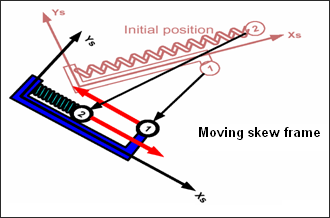

Note: If the local coordinate system is defined through the use of a
moving skew, it is possible to emulate the local X-behavior of a spring TYPE4,
providing the first two nodes defining the moving skew are node 1 and 2 of the
spring (Figure 2).
Figure 2. Deformation in Local X-Direction

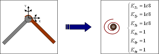

Spring TYPE8 is generally used to model connection between two parts. For example, pivot points
in the steering system are modeled with spring TYPE8. To properly model this type of
connection, translational degrees of freedom must be blocked through the use of rather
high stiffness' and all rotational degrees of freedom must be set free. Below is an
example of such a connection, note that the stiffness values are arbitrary and that they
should be adjusted according to a relevant unit system.
