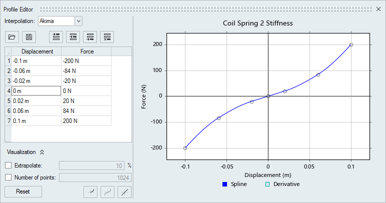

Nonlinear Spring Dampers
Nonlinear stiffness and damping characteristics can be entered for spring dampers for motion analysis.
- Sometimes it is easier to remove the left side data, work on the right side data, and then use the Reflect to Left Side button to reflect your data.
- Clicking the Replace with Linear Equivalent button will use the Stiffness value (shown greyed out on the microdialog) and display it as an editable curve in the graphical area of the Profile Editor.
- The Derivative button in the legend is helpful for the Akima and Cubic interpolation methods because it helps you visualize discontinuities in your data. Introducing more points may help you smooth the profile.
- The Provide Signals to Plant option is available for spring dampers in motion, but is disabled by default. It can be found in the Property Editor and when enabled, the motion Export operation will include the necessary plant signals in the .mdl file for use in MotionView, MotionSolve, and Altair Twin Activate.
- See the Profile Editor for an explanation of the buttons and visualization options.

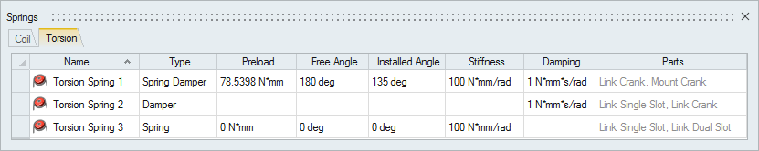

Springs Table
The Springs table lists all of the coil and torsion springs in your model and allows you to edit various attributes. Click the Torsion tab to view torsion springs.
Location: Springs tool, satellite icon ![]()
Figure 3. Springs Table
| To | Do this |
| Rename a spring | Select the cell in the table and then click again to make the field editable. |
| Change a value | Select the cell in the table and then click again to make the field editable. Some fields are for display only. |
| Sort a column | Click the column header. Click repeatedly to toggle between ascending and descending order. |
| Add or remove columns | Right-click on a column header. |
