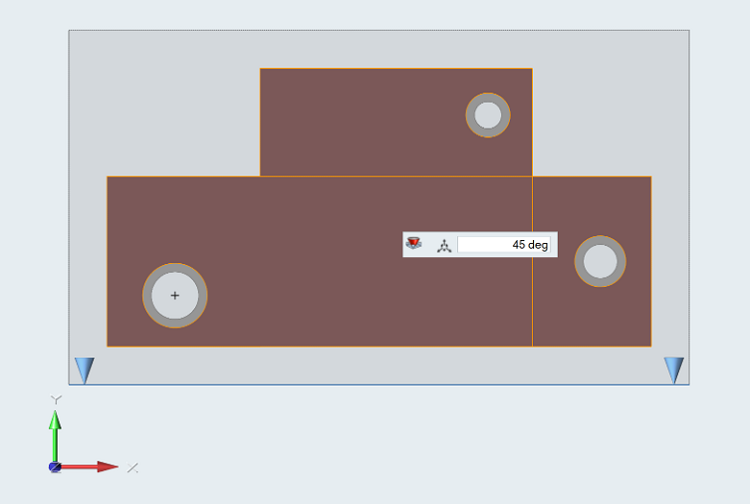

Overhang: 45 Degrees X Direction
Figure 1. Design space with 45-degree overhang in the x direction.

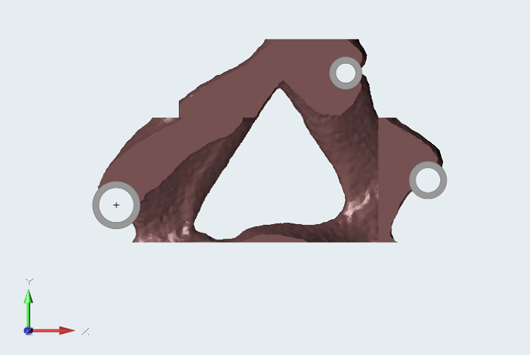

Figure 2. Optimized shape with 45-degree overhang in the x direction.Overhang: 45 Degrees Y Direction

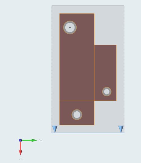

Figure 3. Design space with 45-degree overhang in the y direction.

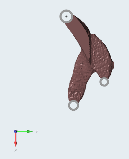

Figure 4. Optimized shape with 45-degree overhang in the y direction.
