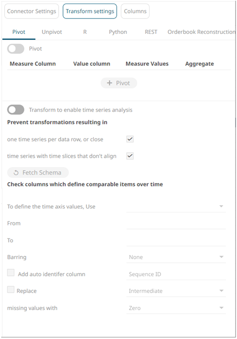

2. Click the Transform Settings button. The Transform Settings pane displays.

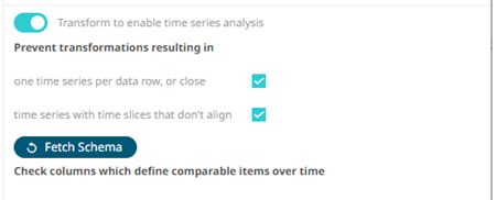

3. Tap the Transform to enable Time Series analysis slider to turn it on.
    NOTE  |
    Once enabled,
The check boxes for: one time series per data row, or close and time series with time slices that don’t align, ensure that duplicate values are highlighted, and the time cube volume is minimized.

5. Select the key or compound key columns from the source list of dimensions to define comparable items over time.
These define each series and correspond to the rows of the generated time cube.
6. Select the column to define the time axis values (Date/Time stamp).
Default value is Date.
7. Set the Date/Time range of the column set in step 5 in the From and To text boxes.
This filters the time series visualization data causing less data to go over the network to the Web client.
    NOTE  |
    The range is not calculated from the start and end values but rather from the Max (the start or the first time slice of the dataset) to Min (the end or the last time slice of the dataset) range. For example, the start and end values can be from 2000-01-01 to 2020-01-01 but the conflation still works as it takes the Date/Time range of the supplied time series.  |

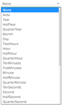

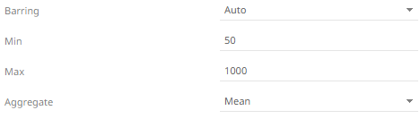

8. Choose whether you want to Conflate the dataset by setting the Barring period to Auto, or a defined value, between Year and Nanosecond.
Setting the barring period conflates the dataset to a defined granularity, returning a set number of data points, by default being between 50 and 1000 for Auto.
As data is potentially being aggregated across time, an Aggregate must be selected. The default conflation aggregate is Mean. Other options include: Sum, Min, Max, First, Last and Count.
Barring can be useful to standardize sparse time series, which is especially common with sensor data, outputting values at defined time intervals, and potentially minimizing the number of rendered data points.
The available barring periods besides Auto are:
Year, Half Year, Quarter Year, Month, Day, Two Hours, Hour, Half Hour, Quarter Hour, Ten Minutes, Five Minutes, Minute, Half Minute, Quarter Minute, Ten Seconds, Second, Half Second, Quarter Second, Tenth Second, Fifty Milliseconds, Ten Milliseconds, Five Milliseconds, Millisecond, Fifty Microseconds, Ten Microseconds, Five Microseconds, Microsecond, Fifty Nanoseconds, Ten Nanoseconds, Five Nanoseconds, Nanosecond.

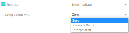

9. Choose whether you want to interpolate for missing values.
The interpolation can replace missing numeric values with Zero, the Previous Value, or an interpolation between known values (Interpolated).

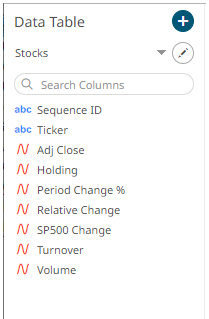

	 the Data Table Editor  layout. On the Open Workbook
	 in Design Mode, a time series data table is visually identified
	 by the time series curve to the left of any numeric time series fields.
