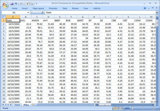

A common alternative format for time series data sets is as follows:
Where the first column represents the Date/Time, and subsequent columns represent the same variable such as Price for a given item. In the MS Excel screen shot above, the price history for a series of stocks is displayed.
By default, this format cannot be used within Panopticon, as it expects each item to occur on a different row, with each variable (such as Price) occupying a single column.
The format is in fact a pivoted version of the format that Panopticon requires.

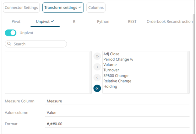

1. To unpivot the data, click the Transform Settings button on the Data Sources Setting pane.
The Transform Settings pane displays.
2.     Click
The Transform Settings pane changes to display the Unpivot Settings.
3. Tap the Unpivot slider.
The
	 Transform Settings button and Unpivot tab change to
	  and
 , respectively and all of the
	 columns are moved to the Unpivot box.
You may opt to move fields from the Columns to Unpivot box, or vice versa, using the following buttons:
 - move all fields from the Columns
	 to Unpivot box
 - move all fields from the Unpivot
	 to Columns box
 - click after selecting one or
	 more fields from the Columns box to move to the Unpivot
	 box
	 more fields from the Unpivot box to move to the Columns
	 box
You can also filter the list of columns by entering a text in the Search Columns search box.
4. Give appropriate names to the Measure and Value columns.
For example:
Measure Column = Return Type
Value Column = Return Value
5. Define the display formats for numeric fields. The default setting is: #,##0.00
6. Refer to Enable Time Series Analysis for more information in enabling this feature.
