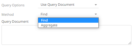

2. To make the Query Document feature of MongoDB available in Panopticon, select Use Query Document.
The Connector Settings pane updates to display the settings of this query option.
For the Method option, select any of the following values:
· Find (Default)
Allows you to fetch a document from a MongoDB collection.

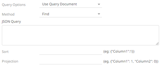

Two more configurable settings are available:

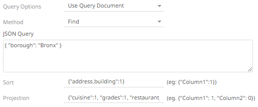

¨ Sort
Provide a JSON object that defines the sort criteria, then set the order to either 1 for ascending or -1 for descending (e.g., {"address.building":1}).
¨ Projection
Provide a JSON object to include or exclude from the result of the Find query.
For example, if a document has 9 documents and you only need to display 5, you can either:
o select 5 JSON objects, then set the limit value to 1 to display
{"cuisine":1, "grades":1, "restaurant_id":1, "name":1, "borough":1}
o select 4 JSON objects then set the limit value to 0 to hide
{"address.zipcode":0, "address.coord":0, "address.street":0, "address.building":0}

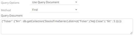

Enter your JSON query document. See http://docs.mongodb.org/manual/tutorial/query-documents/ for more information on the Query Documents feature on MongoDB.
For example, queries from the document look like this: db.inventory.find ( {type: "snacks"} ). The database and collection are already defined in the UI and the Find operation is handled in the code. You only need to enter the JSON query:
{"type":"snacks"}
For more advanced query, it must include surrounding curly braces as well as matching internal braces.
