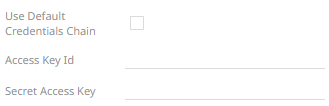

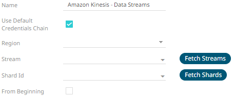

1. Do one of the following:
· Check the Use Default Credentials Chain box to use the default Access Key ID and Secret Key Access, or
· Uncheck the Use Default Credentials Chain box and enter the Access Key ID and Secret Key Access.

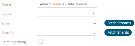

    NOTE  |
    The Access Key ID and Secret Key Access from the AWS account can be configured in three places: · Two properties at the Panopticon.properties file which is available in the AppData folder of Panopticon Real Time o connector.kinesis.datastreams.accesskeyid o connector.kinesis.datastreams.secretaccesskey If this configuration is used, the Use Default Credentials Chain box is not displayed in the connector UI.   This is the recommended way to provide the credentials. · AWS credentials provider chain o Environment Variables - AWS_ACCESS_KEY_ID and AWS_SECRET_ACCESS_KEY o Credential profiles file at the default location - ~/.aws/credentials on Linux, macOS, or Unix, and C:\Users\USERNAME\.aws\credentials on Windows.   · Dedicated fields in the connector Not the recommended configuration.    |

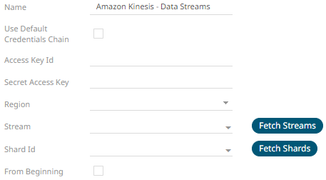

2. Select or define the following properties:
    Property  |
    Description  |
    Region  |
    Physical location of the data center. The list is picked up from the Amazon Kinesis Data Streams Endpoints and Quotas page.  |
    Stream  |
    Name of the stream from where you want to
			 pull the data. Click Fetch Streams   |
    Shard Id  |
    Each connector instance or data source is
			 connected to only one shard. Click Fetch Shards
    From Beginning  |
    The starting position in the data stream from which to start streaming. Default value is unchecked, which means LATEST. When checked, the starting position is set to TRIM_HORIZON.  |
    NOTE  |
    All of the connection settings can be parameterized.  |
