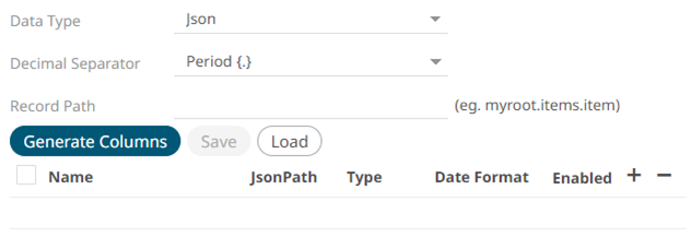

· JSON
If JSON is selected, enter the Record Path which allows the identification of multiple records within the JSON document (e.g., myroot.items.item).

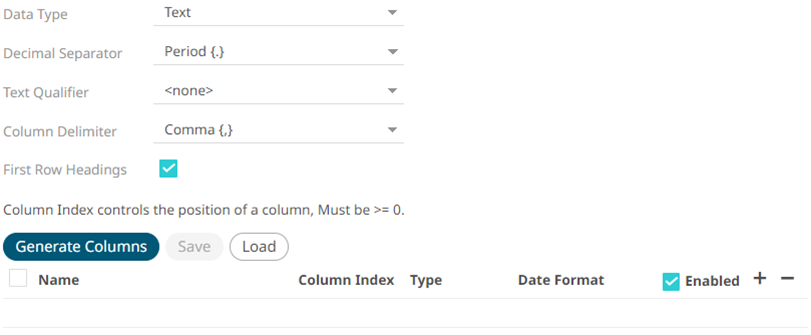

· Text
If Text is selected, confirm the Decimal Separator, Text Qualifier, Column Delimiter, and if the first row of the message includes column headings.

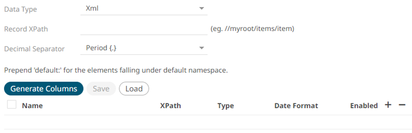

· XML
If XML is selected, enter the Record Path which allows the identification of multiple records within the XML document (e.g., //myroot/items/item).

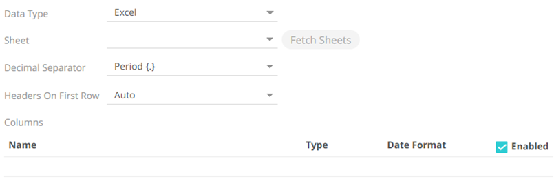

· Excel
For Excel file type, select the required sheet and adjust the headers on first row, if needed.
