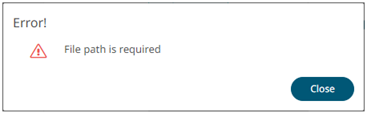

NOTE |
An error notification displays upon fetching sheets/column generation when the File Path is blank. Click Close and enter the file path. |

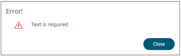

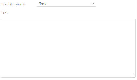

q Text
Then enter the text block to be parsed.
NOTE |
· The Text file source is not available for the MS Excel connectors. · In the Text connector, the column names can be up to 128 characters. If the length of the column names are more than 128 characters, they are truncated to 128 characters. · An error notification displays upon column generation when the Text box is blank. Click Close and enter the text block. |

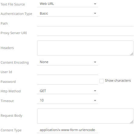

q Web URL
The dialog changes to allow specification of the following:
Property |
Description |

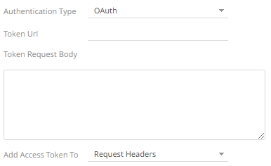

Authentication Type |
· Basic Basic authentication. · OAuth
Then enter the following settings: o Token URL – The URL to retrieve the access token from. o Token Request Body – The request body used for access token requests. o Add Access Token To - The Access token retrieved from the Token URL can be added to headers, URL or request body, depending on how the endpoint needs the token.
§ Request Headers - A header is automatically added to the REST API request. § Request URL - The URL needs to be manually parameterised with a {access_token} parameter, before calling the REST API, the parameter is replaced with the actual token. § Request Body - The Request Body needs to be manually parameterised with a {access_token} parameter, before calling the REST API, the parameter is replaced with the actual token.
NOTES: · The given request body is posted to the Token URL as application/x-www-form-urlencoded, so request body must be formatted like field1=value1&field2=value2, e.g., client_id=xxxx&client_secret=xxxx&grant_type=client_credentials. · Not available in the Streams Simulator connector. · If you have a pre-generated API token for the service you connect to and want to use the Bearer Authentication (Token Authentication), select the Authentication Type Basic, and manually type into the Headers field: Authorization="Bearer xxxxyz_some_secret_token" Leave theUser Id and Password fields blank. The API token in the Headers field can be a Panopticon parameter reference, and the API token can be saved as a global server parameter.
Path |
The absolute path including the HTTP where the file is located. |
Proxy Server URI |
The HTTP Proxy setting that will allow the connector to reach the endpoint. |
Headers |
· Headers are separated by a comma · Each Header is entered as Name = Value, where Name and Value can be enclosed in double quotes to allow inclusion of any character except for double quotes · Name and Value can also be left unquoted, in which case they may not include comma or equals characters |
Content Encoding |
Select the Content Encoding with the HTTP Header: None, GZip, Deflate, or GZip and Deflate |
User Id |
The user Id that will be used to connect to the connector’s service. |
Password |
The password to connect to the connector’s service. Check the Show Characters box to display the entered characters. |
HTTP Method |
Select the appropriate HTTP method for the request from the following options:
· GET – retrieve data · POST – add new data · PUT – replace existing data · DELETE – remove existing data |
Timeout |
The length of time to wait for the server response (10 to 300). Default is 10. |
Request Body |
The Request Body for the HTTP POST. |
Content Type |
The required Content Type. Default is application/x-www-form-urlencoded |
Record Path |
The record path that will be queried by the connector’s path (e.g., myroot.items.item). |
NOTE |
An error notification displays upon column generation when the Path is blank. Click Close and enter the web path. |
