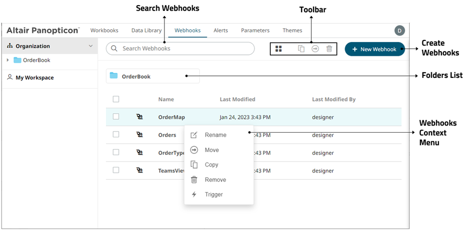

Property |
Description |
Entering text will filter the webhooks. |
Allows copying, moving, and removing of webhooks. Also, to display the webhooks list either on List View or Grid View. |
Allows creating new webhooks. |
Allows renaming, moving, copying, deleting, and enabling of the trigger of webhooks. |
