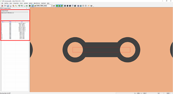

Compare Result
As a result of the comparison, the result window appears in PollEx PCB Modeler.
- Display the contents of the comparison result: When the different parts are
detected, the contents display.

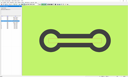

Figure 3. - PDB and GDS2 are identical: When there is no different part.
Display of Individual Detection Results
- PDB: Exists only in the PDB and not in the GDS2.
- GDS2: Exists only in the GDS2 and not in the PDB.
- Both: The types of comparison targets are different.
