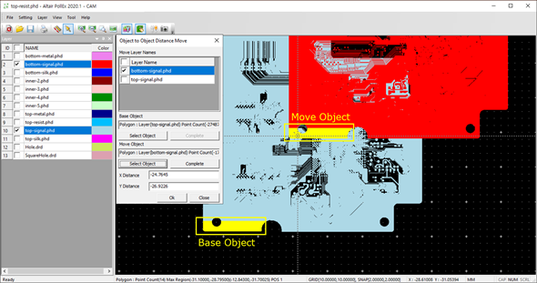

- Object to Object Distance: When you select a shape in the other
layers to be moved after selecting the shape of the target layer,
you can move both shapes in one place.
Figure 1.- Select the particular layer from the layer list.
- Select a target shape in the particular layer.
- Select the moving layer, and select a moving shape of the layer.
- Then, the distance to be moved is calculated automatically. Click OK to move the target Object position.

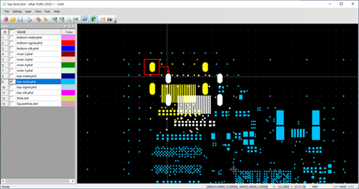

Tip: How to move the selected item in the main working area.
After selecting a moving item, press Enter. It is changed to move mode.
When you press Enter, it is used as a reference to the coordinates of the cursor position.
Use the Enter key
When you select item, it is highlighted in yellow. After you select the coordinates while you press Enter, the Item moves.
