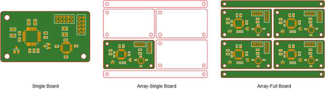

- Layer Set-Up: Specify the artwork layer name to recognize as COC Top and Bottom.
- Board Type: Select reading board type.
Figure 1.- Single Board: Use this option for reading single board.
- Array-Single Board: Use this option for reading array board contour and single board.
- Array-Full Board: Use this option for reading array board contour and full single board.
- Add Drawing Part to Reference Designator: Add drawing part to reference designator.
- Exclude Silkscreen of 0 Line Width: Excludes silkscreen having a line width of zero.
- Include Hatched Copper: Check this option if the hatched copper is used in the design.
- Apply to Environment Setting: Apply settings to the environment setting.
- ASCII Files: At any column if user selects one among five ASCII files,
others are automatically assigned to each folder column. At this time, if
there are multiple files having same name but different version, PollEx PCB will automatically select the latest version.
- Read Sub-Board: Check this option when users use generic parts in array board and want them to be part of sub board.

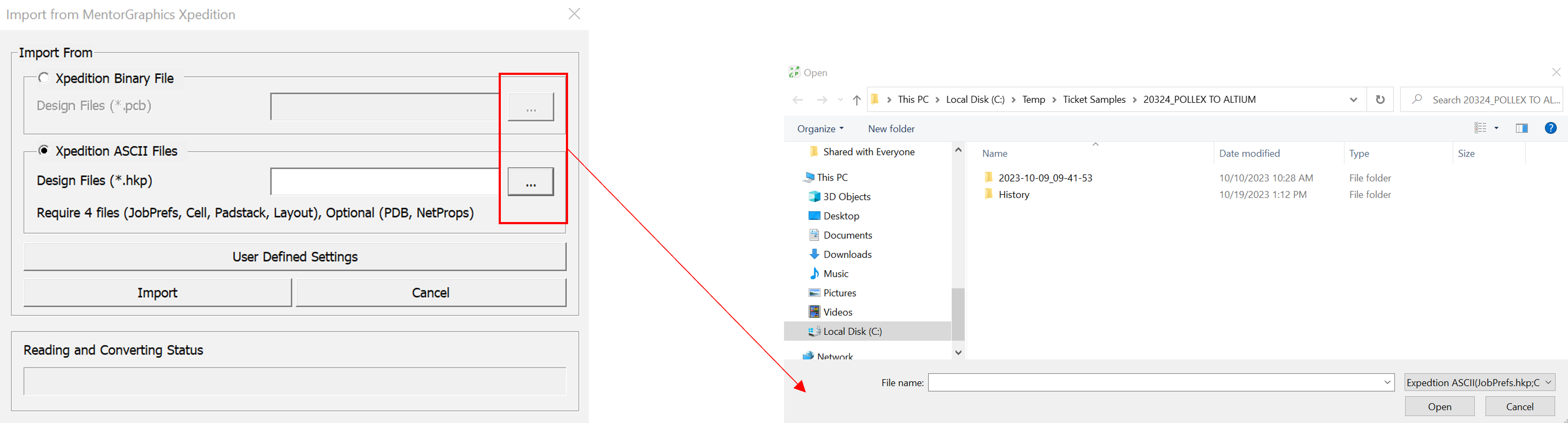

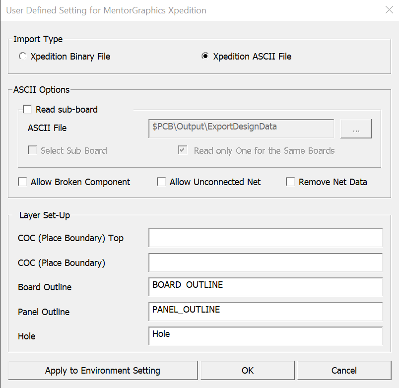

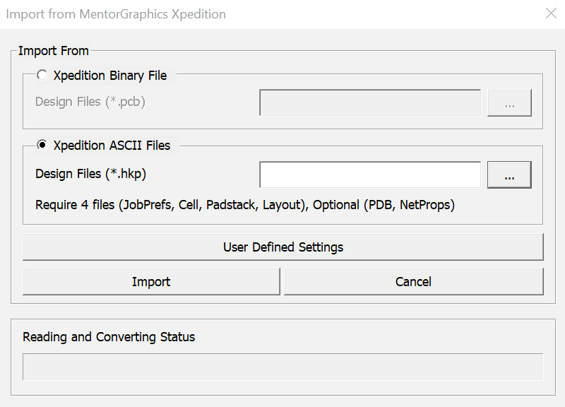

Mentor Graphics Xpedition
| File Name | Description |
| Cell.hkp | Component placement information |
| JobPrefs.hkp | Layer information |
| Layout.hkp | Routing information |
| NetProps.hkp | Net information |
| Padstack.hkp | Padstack information |
| PDB.hkp | Part library information |
