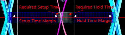

Setup/hold timing margin is automatically measured and a timing margin report is created.

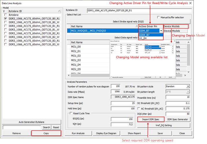

Creating a network analysis model starts with selecting data strobe net and data byte net from the net listing. The net name is initially assigned to the model name which can be changed by users. To analysis read and write cycle, CPU component must be selected for write cycle analysis and MEMORY component must be selected for read cycle analysis using Active Driver Pin.
The analysis is performed upon selecting Run Analysis menu.

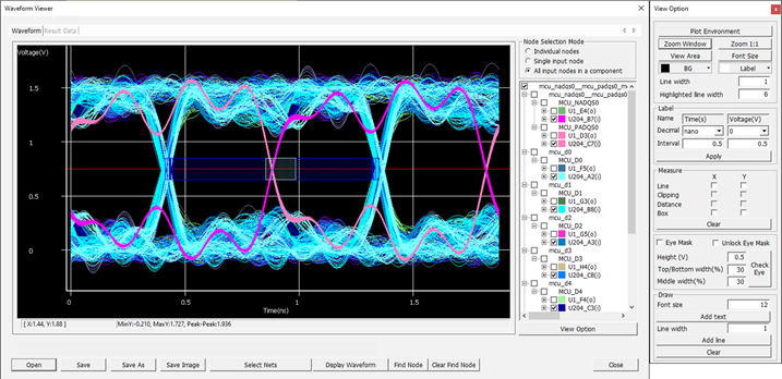

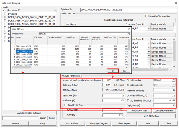

Eye Diagram analysis is running transient circuit simulation on the network model to obtain eye diagrams at the input nodes. An eye diagram or eye pattern is obtained from overlapping multiple waveforms at the receiver node of a net generated by randomly selected high/low states of the input signals for the selected net and adjacent nets. The coupling effects from the adjacent nets are reflected in the waveforms. Prior to running analysis, you can change the analysis control parameters such as the number of random pulses and bit pattern style.
