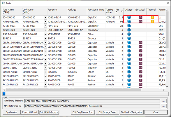

Assign Part(s) Properties Automatically
- From the menu bar, click . The Parts dialog opens.
- In the Part library directory menu, click
to explore the library path for the unified parts, select the desired
UPFs folder, and click OK. - Click Synchronize to begin assigning the part properties.
There were no iconic marks which are shown in the Electrical, Thermal, and Reference columns.
Figure 1. Iconic Marks in Parts dialog
- Contents name under UPF Name column denotes that UPV file exists under local Parts folder for those parts.
- Icon under Package column denotes that 3D package geometry is linked with unified part.
- Icon under Electrical column denotes that electrical buffer model is called from unified part.
- Icon under Thermal column denotes that thermal information is called from unified parts.

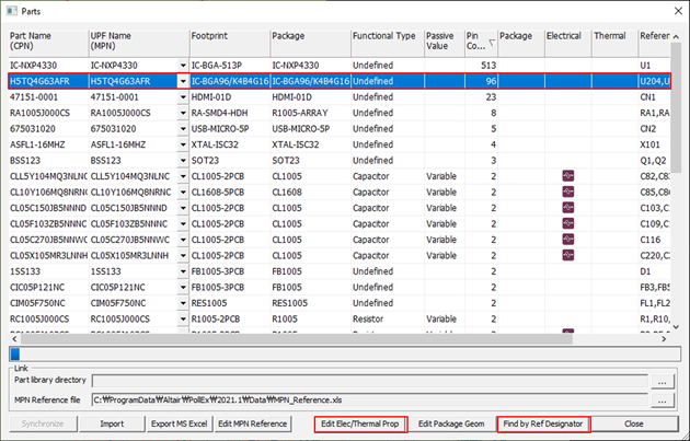

Assign Part Properties Individually
When the unified parts are not available, you need to specify the needed part properties separately for each part depending on the desired analysis type. To do analysis, electrical and thermal properties are essential.
To open the Electrical & Thermal Properties dialog, double-click the highlighted H5TQ4G63AFR part.
Figure 3. Find Component by Refdesignator Number

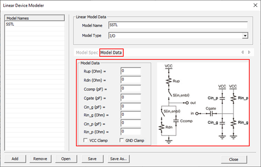

- Linear Device Modeler: Enable to define simple linear device model for IC pin which will be worked as one of the types among Input, Output, IO or Terminator. Depending on the selected working type of these, you should define the bias and RLC values configuring the circuit topology.
To define a new linear device model or manage it, click Linear Device Modeler in the Electrical & Thermal Properties dialog.
Click Add to define certain model name and it will be shown at SSTL, to define or modify the model SSTL which should be selected by mouse clicking. You can select the model type and assign proper properties requested through two tab menu, for example Model Spec and Model Data.
Figure 4. I/O Buffer Model Simulation Parameter
