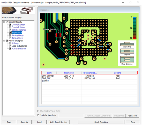

Impedance
This item analyzes and checks single-ended and differential impedance of target nets.
- Check the single-ended impedance.
- Check the differential impedance (Characteristic, Zdiff,
Zcommon).

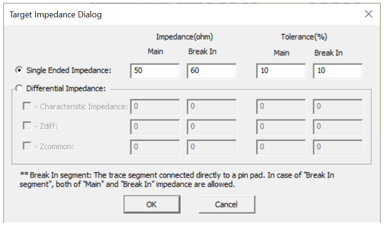

- Net Group: Select target net groups to be tested. Allow multiple net groups.
- Target Impedance: You can assign required impedance for main area and break
in area. You can also set tolerance (%) for each main area and break in
area.

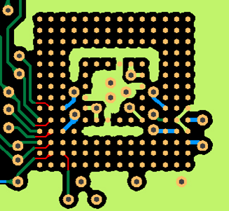

Figure 3. Break-In/Out Definition - Options: You can assign PIN/VIA Escape length and other options.
- Pin Escape: Enter a radius of circular region around pins to be excluded for the rule check.
- Via Escape: Enter a radius of circular region around vias to be excluded for the rule check.

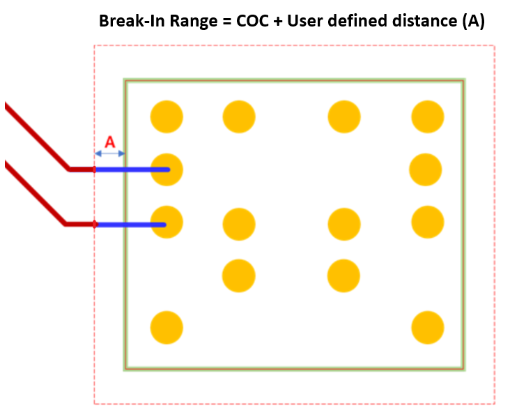

- Ignore trace shorter than: the trace shorter than this length will be ignored.
- Break-In range (COC+distance): Enter Break-In range value. The break-in
range refers to the sum of the distance within the COC line and the user
defined distance outside of COC line.
