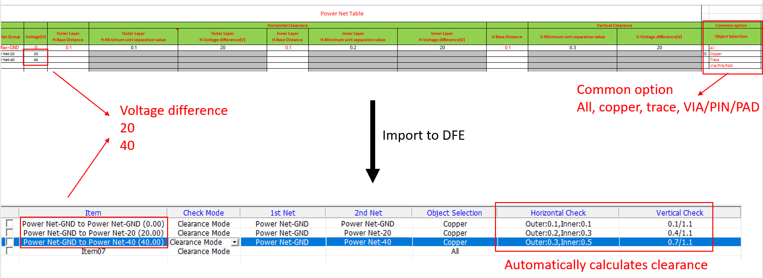

- Auto Net to Net Combination: Generate combination pair of selected net group.
- Import Power-net clearance excel table: Import excel table that
automatically calculates vertical and horizontal clearance based on the
difference in voltage. The user can define the voltage difference and its
corresponding clearance value as required. In the figure below, the user has
set up to get 0.1mm clearance for every 20 voltage difference. The vertical
and horizontal clearance values are automatically calculated and imported
based on this setup.
