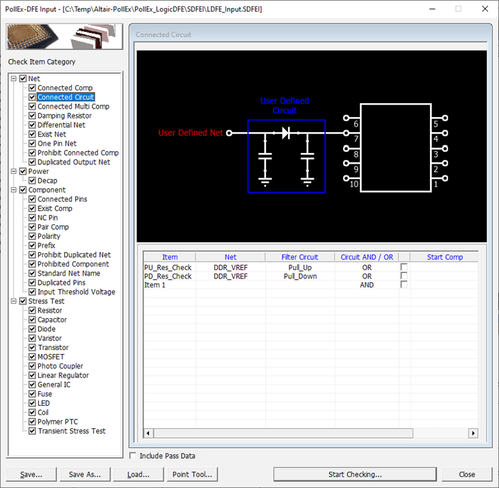

Connected Circuit
Rule check for special purpose circuits.
- Item: Input item name.
- Net: Select a target net group that needs a filter circuit.
- Filter Circuit: Select rectification filter circuit. Multi selection is allowed.
- Circuit AND/OR:
If filter components are more than one, use this option.
- OR: If one of filter component is exist, it passes.
- AND: If all selected filter components are existing, it passes.
- Start Comp: Select a specific component group that included in filter circuit. The DFE choose target nets which is connected to this component among net group defined at stage Net.
- Duplication Check: If more than one same type circuits are connected to same net, it fails.

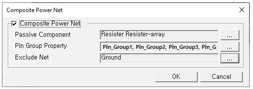

- Composite Net:
Upon selecting this menu, DFE use composited power net instead of single
power net. Double-click the item field, then Composite Power
Net dialog will be displayed.
Figure 2. - Passive Component: The DFE make composite net for which are connected through this passive component.
- Pin Group Property: In the case of a passive component of 3pin or more, pin mapping information is required for composite. Set the Property Name with pin mapping information.
- Exclude Net: Nets which should not be merged into composite net.
