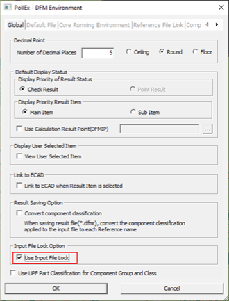

Setup DFM environment.
From the menu bar, click Option > DFM > DFM Environment.
The PollEx - DFM Environment dialog opens.
In the PollEx - DFM Environment dialog, enable the
Use Input File Lock checkbox to use the DFM
input setup lock.

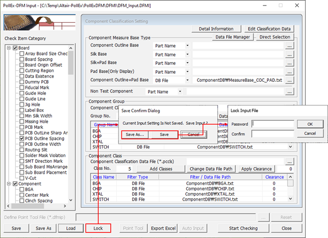

Lock input file.
In the PollEx-DFM Input dialog, click
Lock to lock a DFM input setup file.
Note: If the DFM input file is not saved, you will be prompted to save the file before setting a password.The Lock Input File dialog opens.
In the Lock Input File dialog, enter a password
for access to the DFM input file.

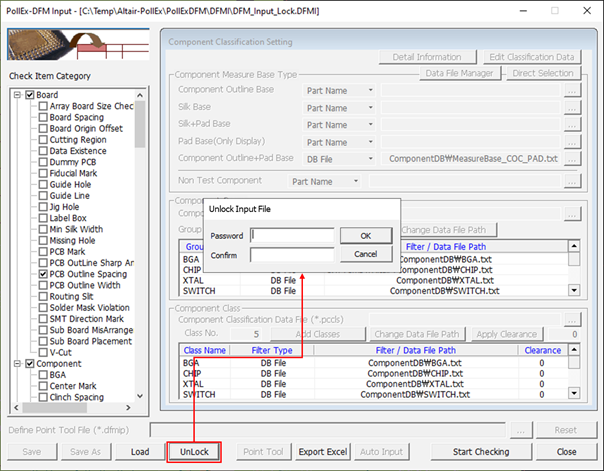

Unlock input file.

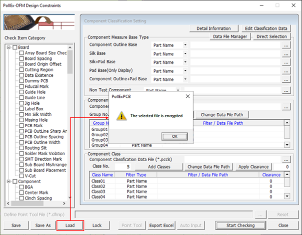

If you load a locked input file, you will get a warning message saying the selected file is encrypted.
Figure 3.-
Unlock to load a locked DFM input file.
The Unlock Input File dialog opens.
In the Unlock Input File dialog, enter the
password in the Password and Confirm fields to modify the input
file.
- Click OK.
- Repeat step 2 to lock the DFM input file.
