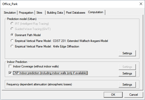

Specifying the Computation Method
Select the dominant path model (DPM) as computation method.
