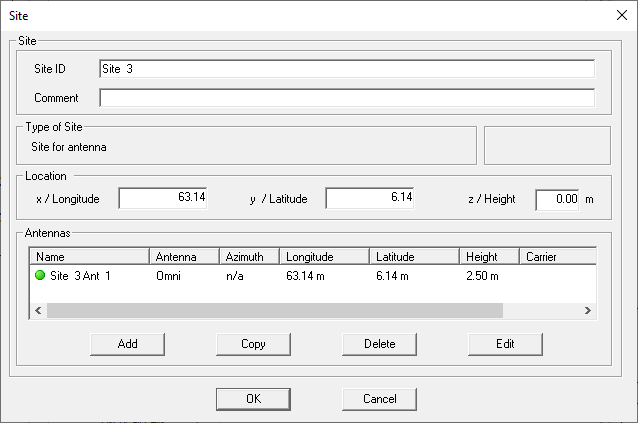

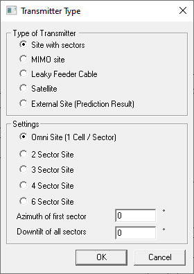

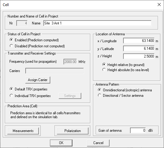

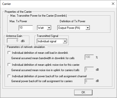

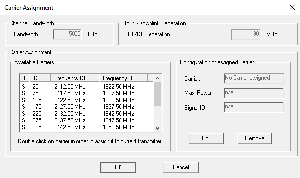

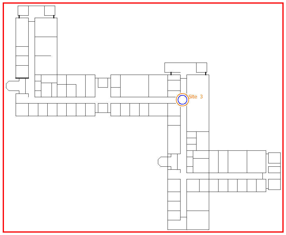

Define the third site, place the third omnidirectional antenna at this location, and assign a carrier. The antenna is placed at a height of 2.5 m above ground.
Figure 1. Location of the third antenna site.
