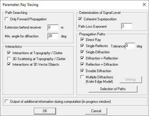

Settings
Figure 1. The Parameter: Ray Tracing dialog.
- Path searching
- Only Forward Propagation
- When activated, only forward propagation will be considered i.e. no back-scattering.
- Extension behind receiver
- The vertical profile between Tx and Rx will be extended by this value, only relevant if not limited to forward propagation.
- Min. angle for diffraction
- Only terrain wedges will be considered which have an inner wedge angle smaller than (180° minus defined minimum angle).
- Interactions
- Interactions at Topography / Clutter
- This option activates the interactions (reflection & diffraction) at the topo & clutter 2D vertical profiles.
- 3D Scattering at Topography / Clutter
- Based on this option, the 3D scattering outside the 2D vertical profiles can be activated.
- Interactions at 3D Vector Objects
- This option allows to consider interactions (reflection and diffraction) at 3D vector objects. For this purpose the SRT propagation model is applied, where further settings might be configured beyond the ones given on this dialog.
- Determination of signal level
- Coherent Superposition
- When activated the ray contributions will be added coherently, otherwise the superposition is done incoherent i.e. by adding the power values.
- Path Loss Exponent
- This value defines the path loss exponent used in simulation, here default value is 2.0 for the propagation in free space.
- Propagation paths
- Direct Ray
- Activates the computation of the direct ray.
- Single Reflection
- Activates the computation of the ground-reflected ray.
- Tolerance
- Tolerance up to which the ground-reflected ray is computed if the condition for specular reflection is not perfectly fulfilled.
- Single Diffraction
- Activates the computation of the single diffracted ray.
- Diffraction + Reflection
- Activates the computation of rays having first a diffraction followed by a reflection.
- Reflection + Diffraction
- Activates the computation of rays having first a reflection followed by a diffraction.
- Double Diffraction
- Activates the computation of the double diffracted ray.
- Multiple Diffractions (Knife Edge Model)
- Activates the computation of rays with multiple diffraction,
recommended for shadowed environments where the computation
of the previous ray types is not sufficient.
- Settings
- Allows to configure the parameters for the Knife Edge diffraction model.
- Selection of Paths
- Allows to limit the number of computed propagation paths by number, by maximum path loss or by maximum dynamic range.
- Output of additional information during computation (in progress window)
- Activating this check box will provide further details about the computation progress.

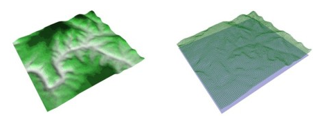

The approach of the rural ray-tracing model requires the conversion of the topography data (in pixel format) to a 3D vector data format. This step has to be made once for each scenario and can be done using the conversion functions included in WallMan. After conversion is done, the rural vector database is written to a file with the extension .tdv. This file has to be used to set up the rural simulation project if the rural ray-tracing should be used as propagation model.
- Topography: Topo maps must be converted from raster data to vector data using WallMan
- Clutter/land usage: Clutter maps must be converted from raster data to vector data using WallMan
- Vector objects: Additional vector objects (.idb files) can be added during the conversion using WallMan
Figure 2. Topography database in raster format (on the left) and topography database in vector format (to the right).

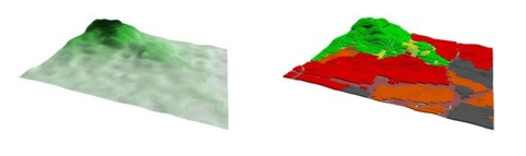

Consideration of Land Usage (Clutter) Data
The additional consideration of land usage (clutter) maps is of course also possible. Similar to the topographical data, the clutter maps are also converted from raster data to 3D vector data taking account the clutter heights and the electrical properties of the materials defined for each clutter class individually. This approach allows a real 3D representation of the land usage maps.
Figure 3. Raster topography without display of land usage (on the left) and raster topography with land usage in vector format (to the right).

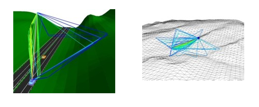

Additional Obstacles
Beyond topography and land usage also arbitrary 3D vector objects can be defined in the scenario to model buildings, towers. These obstacles can either be converted from CAD data or they can be drawn in 3D with WinProp's CAD tool WallMan into the vector database. Of course the material properties of each 3D obstacle can be defined individually. The vector objects have to be saved in a regular indoor database file (.idb) and can be additionally considered during the conversion of topo and clutter data into the WinProp file format.
Figure 4. Predicted propagation paths in time-variant environment (on the left) and predicted propagation paths with wire frame topography (to the right).
