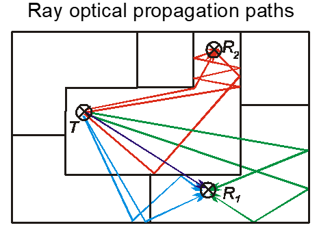

Figure 1. Principle of ray-optical models.
As smaller wavelengths (higher frequencies) are considered, the wave propagation becomes similar to the propagation of light. Therefore a radio ray is assumed to propagate along a straight line influenced only by refraction, reflection, diffraction or scattering (see Figure 1) which is the concept of geometrical optics (GO). The criterion taken into account for this modeling approach is that the wavelength should be much smaller in comparison to the extension of the considered obstacles, which are typically the walls of a building. At the frequencies used for mobile communication networks, this criterion is also sufficiently fulfilled inside buildings.
