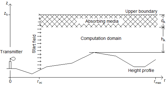

Basic Principles
Figure 1 shows the vertical terrain section and the computation domain of the PE model.
Figure 1. Vertical terrain section and computation domain.
Neglecting backward propagation and assuming a rotationally symmetric problem, a partial differential equation of parabolic type out of the Maxwell equations can be derived:
This so-called standard parabolic equation (SPE) leads to valid results if the propagation angle with respect to the horizon is in the range, –15° to 15°. Therefore the PE must not be used in the vicinity of the transmitter.
A finite difference technique solves the PE in the computation domain using an iterative method. In WinProp the required start field at is computed using free space propagation and a single ground reflection ray.

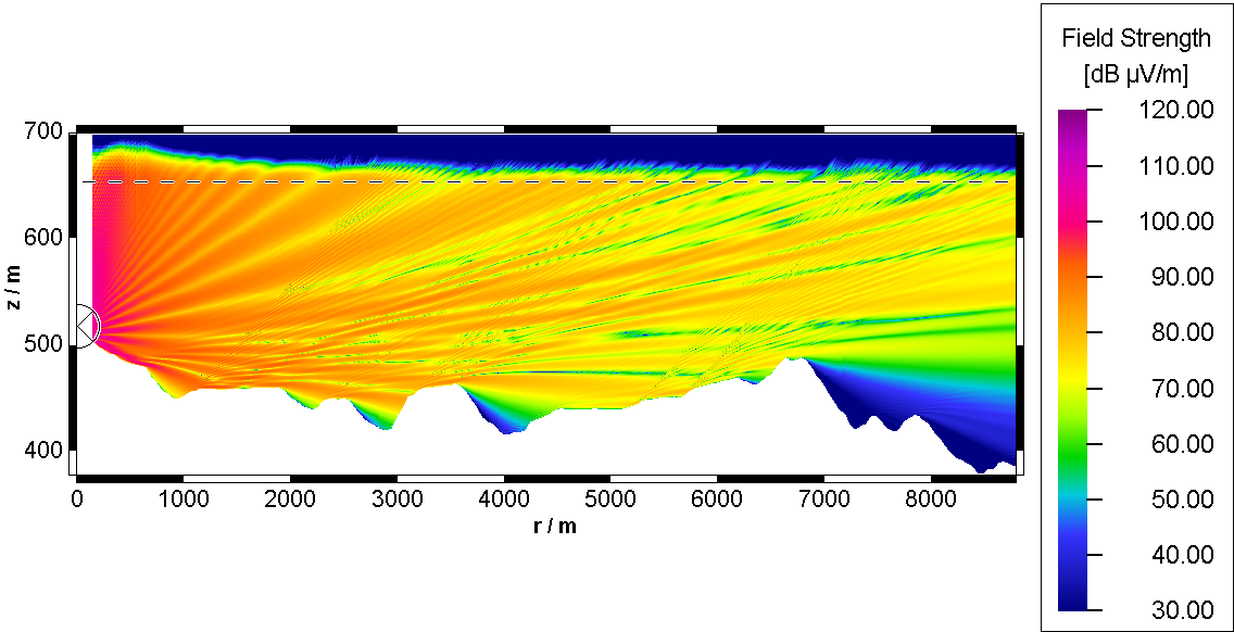

Absorbing Media
As the implementation of a transparent boundary condition at the top of the computation domain yielded too high computation times, an absorbing medium is used instead to avoid reflections at the upper boundary. Having a width of about wavelengths, the absorbing medium works well for all frequencies if an adequate distance to the highest terrain point is assumed.
The prediction plot in Figure 2 shows the field in the artificial absorbing medium above the dotted line.
Figure 2. Sample prediction (945 MHz, vertical terrain section).

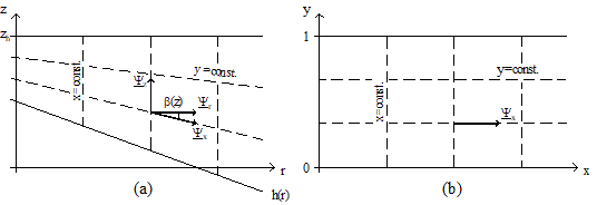

- Terrain profile approximation with coordinate transformation
Another possibility to prevent numerical instabilities is the transformation of the irregular computation domain to a rectangular area as shown in Figure 4 for down-sloping ground.
Figure 4. Transformation of the computation domain.Therefore the coordinate transformation
(6) (7) (8) Because of the distortion of the computation grid, the transformation should only be used for slight hilly terrains.
