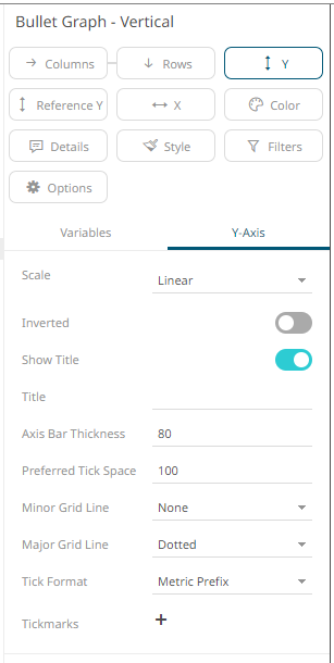

Other visualization-specific properties can be set by clicking on either:
q  Y-Axis  variable drop area then selecting the Y-Axis tab (for Vertical Bullet Graphs) or
q  X-Axis variable drop area then selecting the X-Axis tab (for Horizontal Bullet Graphs)

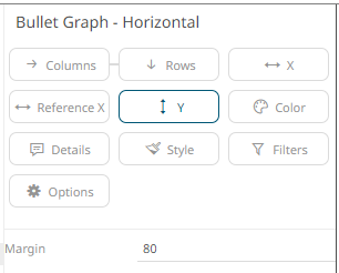

Furthermore, there is the X-axis setting (for Vertical Bullet Graphs) or Y-Axis setting (for Horizontal Bullet Graphs):
Setting
Margin
The margin in pixels for the axis. If set to zero, the axis is removed.

·           The Bullet Graph – Vertical visualization has the following specialized default properties:
In the Cross Y-Axis:
o   Leaf Bar Thickness – 80
In the Cross X-Axis:
o   Leaf Label Angle – 90
o   Min Interval Length – 20
o   Max Interval Length - 20
