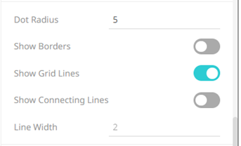

The dot plot settings pane is displayed after clicking the Options  button.
Setting
Dot Radius
Specifies the radius of each dot in pixels.
Show Borders
Determines whether a border is drawn around each dot.
Show Grid Lines
Determines whether grid lines are drawn through each dot.
Show Connecting Lines
Determines whether a line is drawn between the dots category constituents.  Allows a categorical line graph to be displayed.
Line Width
Specifies the width in pixels of the line if enabled.

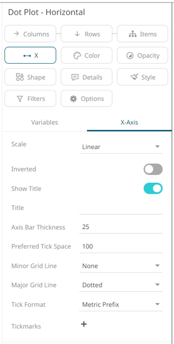

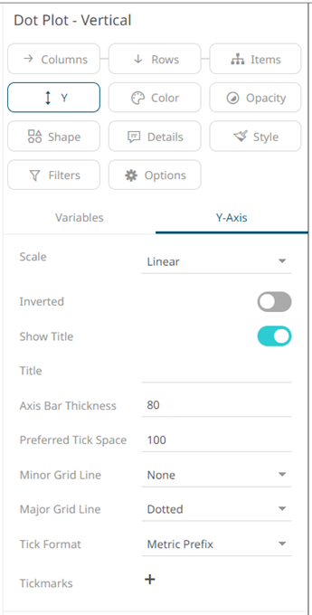

Other visualization-specific properties can be set by clicking on either:
q  Y-Axis  variable drop area then selecting the Y-Axis tab (for Vertical Dot Plots) or
q  X-Axis variable drop area then selecting the X-Axis tab (for Horizontal Dot Plots)
