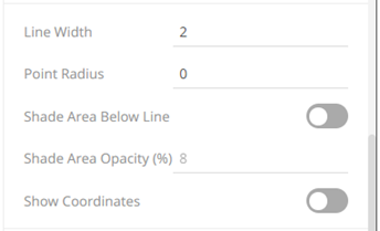

The numeric line graph settings pane is displayed after clicking the Options  button.
Setting
Line Width
Specifies the width in pixels of the lines.
Point Radius
Specifies the radius of each point in pixels that the line passes through.
 Shade Area Below Line
Defines that opacity shades are applied between the lines and the zero Y grid line.
Shade Area Opacity (%)
Specifies the opacity (transparency) of the shaded area, expressed in percent 0-100 of the opacity value currently set on the line.
Show Coordinates
Determines whether the graph coordinates (i.e., X-Y plots, or Date/Time-Y plots) on mouse over are displayed in the visualization.

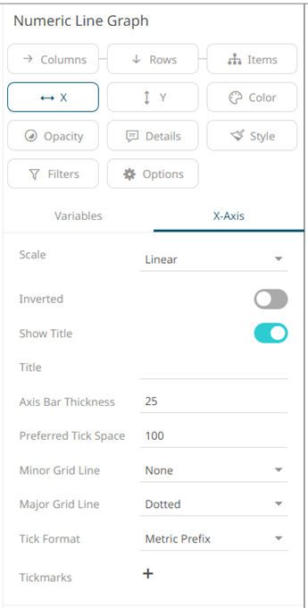

Other visualization-specific properties can be set by clicking on the X-Axis variable drop area and then selecting the X-Axis tab:

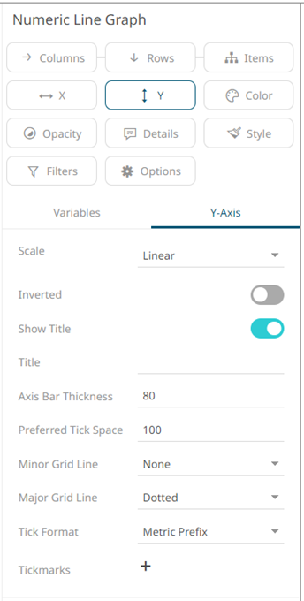

Or also, by clicking on the Y-Axis variable drop area and then selecting the Y-Axis tab:
