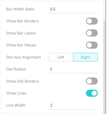

The pareto chart settings pane is displayed after clicking the Options  button.
Setting
Bar Width Ratio (%)
Defines the ratio of the width within the bars. Default is .5.
Show Bar Borders
Determines whether borders are drawn around bars or stacks within bars.
Show Bar Labels
Specifies whether labels are drawn inside the bars.
Show Bar Values
Specifies whether values are displayed in bars.
Dot Axis Alignment
Determines whether the dot axis is aligned to the Right or Left.
Dot Radius
Specifies the radius of each data point in pixels.
Show Dot Borders
Determines whether a border is drawn around each dot.
Show Lines
Determines whether a line is drawn between the dots category constituents. Allows a categorical line graph to be displayed.
Line Width
Specifies the width in pixels of the line if enabled.

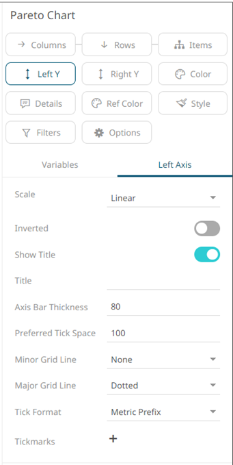

Other visualization-specific properties can be set by clicking on the Left Y variable drop area and then selecting the Left Axis tab:

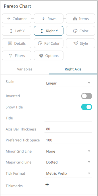

Or also, by clicking on the Right Y variable drop area and then selecting the Right Axis tab:
