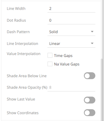

The line graph settings pane is displayed after clicking the Options  button.
Setting
Line Width
Specifies the line width in pixels.
Dot Radius
Specifies the radius of each data point in pixels.
Dash Pattern
Specifies the line pattern. Available options are:
·         Dotted
·         Dashed
·         Solid
Line Interpolation
Specifies whether the line is Stepped, Linear, or Smooth Interpolation.
Value Interpolation Time Gaps
Determines whether time axis gaps (Working Week/Time) are interpolated.
Value Interpolation Na Value Gaps
Determines whether Na value (or missing) gaps are interpolated.
Shade Area Below Line
Defines that opacity shades are applied between the lines and the zero Y grid line.
Shade Area Opacity (%)
Specifies the opacity (transparency) of the shaded area, expressed in percent 0-100 of the opacity value currently set on the line.
Show Last Value
Determines if the flag of the last value will be displayed.
Once enabled, the Y-Axis Alignment settings section displays.
·         Select  to display Y-axis on the left side.
·         Select  to display the Y-axis on the right side.
·         Enter the Last Value Margin. Default is 80.
·         Check the Show Last Value Title box to display the title of the last value in the flag.
Show Coordinates
Determines whether the graph coordinates (i.e., X-Y plots, or Date/Time-Y plots) on mouse over are displayed in the visualization.

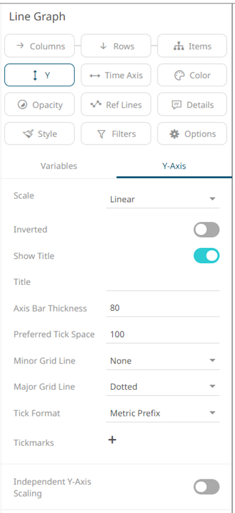

Other visualization-specific properties can be set by clicking on the Y-Axis variable drop area and then selecting the Y-Axis tab:
Setting
Independent Y-Axis Scaling
Determines whether to have each visualization Y-axis in a cross tab automatically scaled independent of the others.
