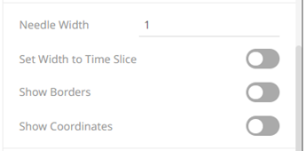

The stacked needle graph settings pane is displayed after clicking the Options  button.
Setting
Needle Width
Specifies the width in pixels for each needle:
Set Needle Width to Time Slice
Determines whether the Needle width will be extended to the width of the time slice.
NOTE: Will not go past a null/empty time slice.
Show Borders
Determines whether borders are drawn around needles. These are only visible if the Needle Width is greater than 1 pixel.
Show Coordinates
Determines whether the graph coordinates (i.e., X-Y plots, or Date/Time-Y plots) on mouse over are displayed in the visualization.

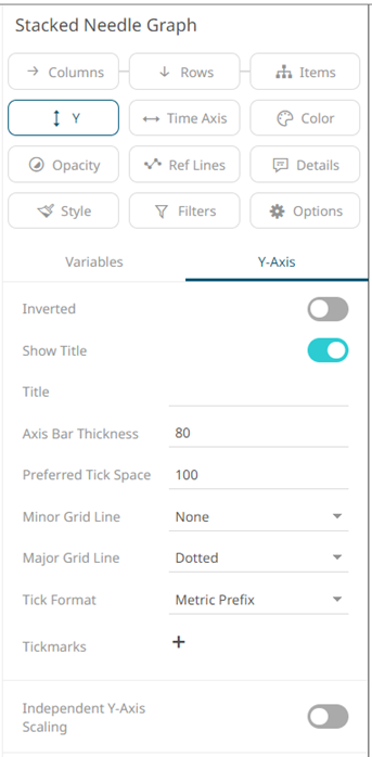

Other visualization-specific properties can be set by clicking on the Y-Axis variable drop area and then selecting the Y-Axis tab:
Setting
Independent Y-Axis Scaling
Determines whether to have each visualization Y-axis in a cross tab automatically scaled independent of the others.
