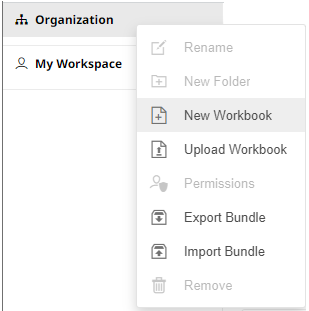

·        Click  on the Welcome or Workbooks page.
·         Right-click on a folder or sub-folder then select New Workbook in the context menu on the Workbooks page.

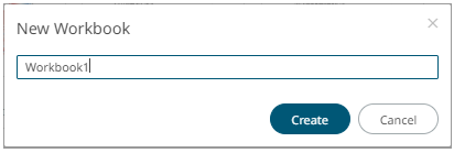

The New Workbook dialog displays.
2.     Enter the name of the workbook then click .

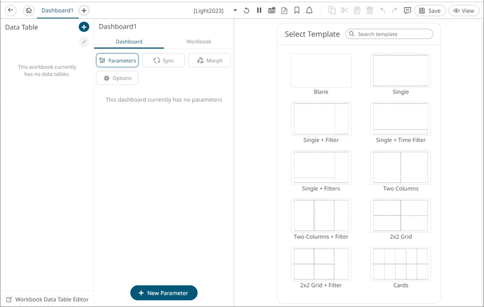

The new workbook with a dashboard page (named Dashboard1) is displayed on the Open Workbook in Design Mode.
The dashboard name by default is editable. You can enter a descriptive dashboard name.

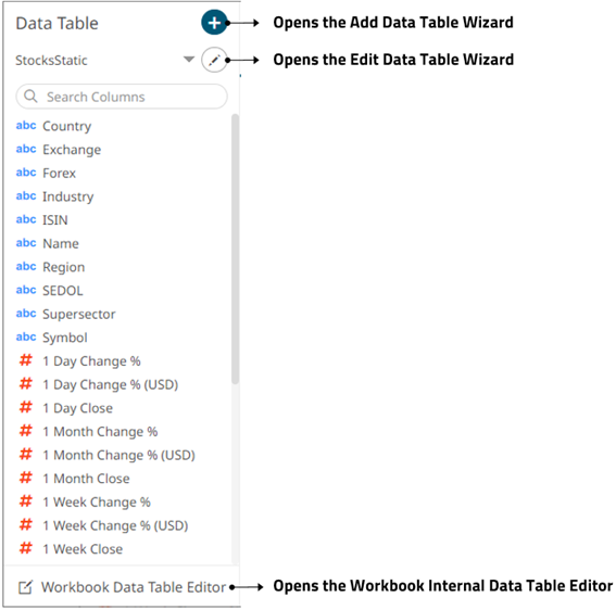

To proceed in creating a workbook, data tables must be added first. On the Data Table pane, there are three options to add or edit data tables.
You can also drag and drop a data file to the dashboard. This opens the Data Table Wizard where you can configure the data table.
See Adding and Managing Data Tables for more information.
