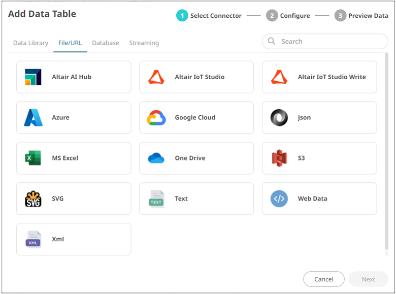

q  Add Data Table Wizard in a Worbook
On the Data Table pane, click Add Data Table . The Add Data Table Wizard displays.
This wizard allows you to fetch data from data sources and the data library.
See Working with Add Data Table Wizard for more information.

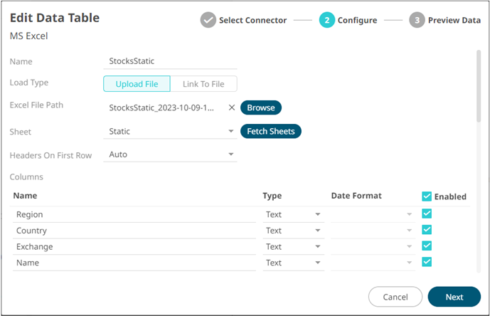

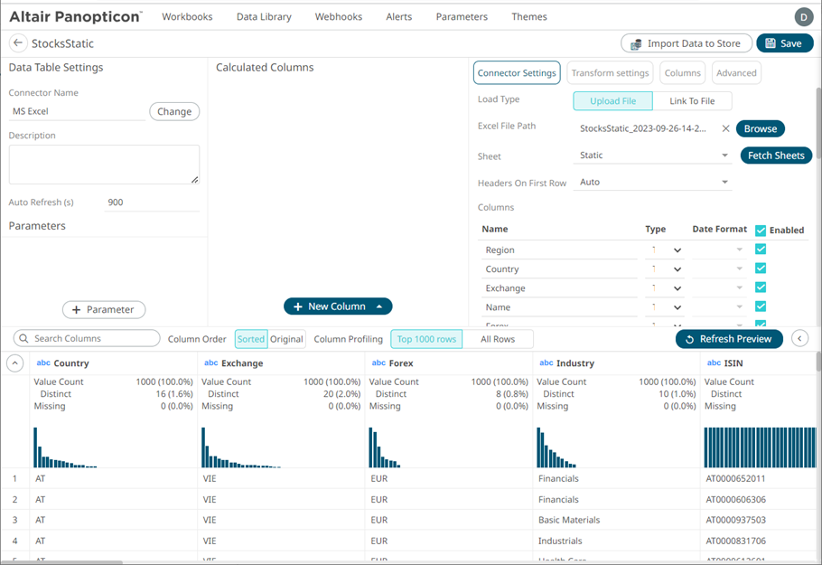

q  Edit Data Table Wizard in a Workbook
On the Data Table pane, select a data table in the drop-down list and then click either of these Edit Data Table icons:
·          for data table saved to the workbook
The Edit Data Table Wizard displays.
·          for data table saved to the data library
The Data Table Editor displays.
For more information on working with this view, see Working with Data Table Editor.

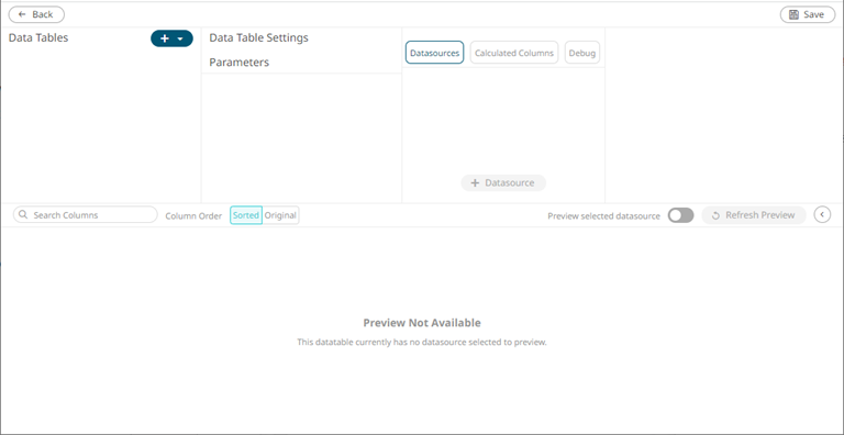

q  Workbook Internal Data Table Editor in a Workook
On the Data Table pane, click Workbook Data Table Editor. The Workbook Internal Data Table Editor displays.
See Working with Workbook Internal Data Table Editor for more information.

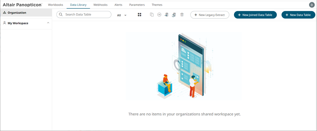

q  Data Library Page
Click the Data Library tab. The Data Library page displays.
See The Data Library Page to create data tables that will be used in building workbooks.
