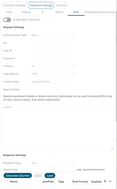

1.     Click the Transform Settings button on the Data Sources Setting pane.
The Transform Settings pane displays.
2.     Click .
The Transform Settings pane changes to display the REST Transform Settings.
3.     Tap the Enable REST Transform slider.
The Transform Settings button and REST tab change to  and , respectively.

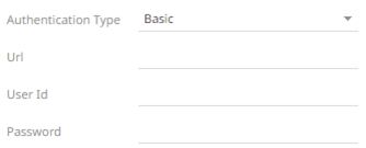

·         Basic
Enter the URL of the REST API. Then enter the User Id and the Password that will be used to the connect to the REST API.

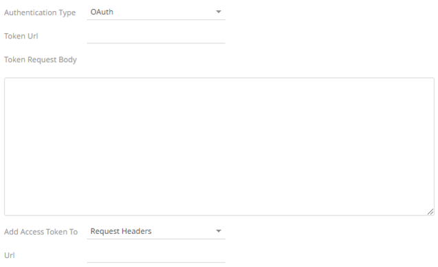

·         OAuth
Then enter the following settings:
o    Token URL – The URL to retrieve the access token from.
o    Token Request Body – The request body used for access token requests.
o    Add Access Token To - The Access token retrieved from the Token URL can be added to headers, URL or request body, depending on how the REST endpoint needs the token.
§  Request Header - A header is automatically added to the REST API request.
§  Request URL - The URL needs to be manually parameterised with a {access_token} parameter, before calling the REST API, the parameter is replaced with the actual token.
§  Request Body - The Request Body needs to be manually parameterised with a {access_token} parameter, before calling the REST API, the parameter is replaced with the actual token.
o    URL – The URL of the REST API.

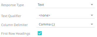

·         Text
If Text is selected, confirm the Text Qualifier, Column Delimiter, and if the first row of the message includes column headings.
The Column Index controls the position of a column, ensure the value is >= 0.
