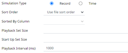

  6. Select the Simulation Type:
    For time-based simulation, if the Date/Time column have improper dates, it will fail and stop.
    • Record
      Sends the number of records for each interval of time. By default, records are sent in the same order of the source.
      This simulation type allows the specification of the following:
      • Sort Order
        When you select the Use file sort order, it will use the default sorting order of the file.
        When you either select Ascending or Descending as the Sort Order, this enables the Sorted by Column drop down list.
        Select the column that will be used for the sorting.
      • Playback Set Size
        The number of records set to be updated during simulate/playback.
      • Start Up Set Size
        The number of records set to be published initially (on start-up).
      • Playback Interval (ms)
        The update interval period for the record-based playback. Default is 1000 (ms).
