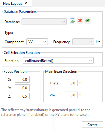

The fields for the layout generation are explained in the following.
Figure 1. New Layout Parameters tab
- Database: Shows the selected database file to create the new
layout. With the
button a file chooser window will
prompt the user to add a database file.
Opens a database information tab on
the main panel of the application. With this button, it is possible to visualize all
the relevant parameters of the database: cell dimensions, cell replications, material
considered, skew angle, geometrical models, plots of the phase cells,…The
button detaches the specified database
from the layout. - Component: Allows the user to select the desired polarization component of the database to generate the layout.
- Frequency: Allows the user to select the desired frequency of the database to generate the layout.
- Function: Allows the user to select the desired user function to assign one cell of the database to every position of the base geometry.
- Focus Position: Allows the user to define the point of the source.
- Main Bean Direction: Allows the user to define the output direction of the main beam.

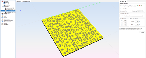

Is possible to specify more than one database in order to create more complex layouts. In order to do so, user must specify the parameters of each database file separately.
Figure 2. Multi database ReflectArray Layout
