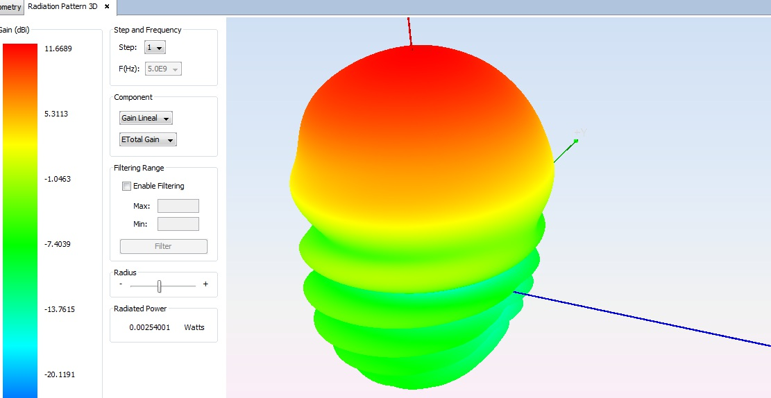

Figure 1. 3D radiation pattern - Step 1: 5.0e9 Hz - Step 2

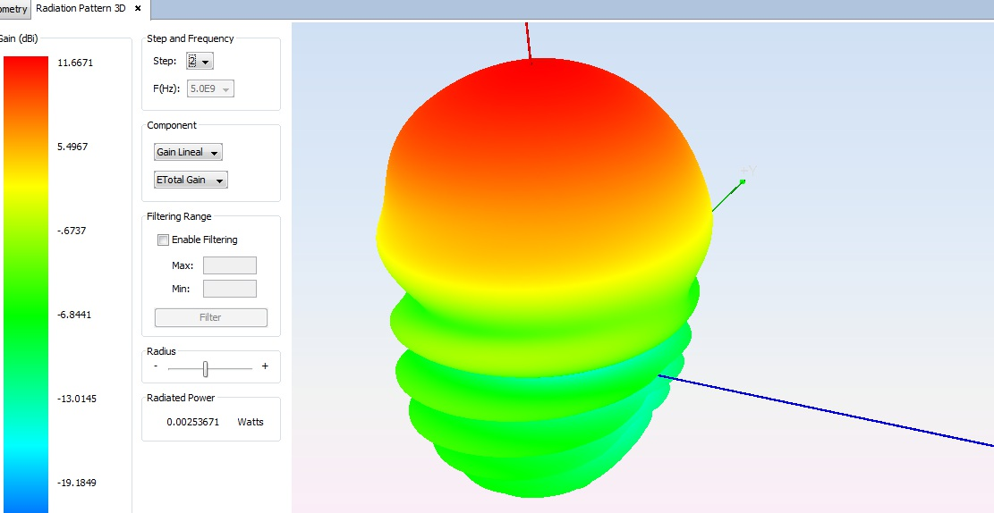

Figure 2. 3D radiation pattern - Step 2: 5.0e9 Hz - Step 3

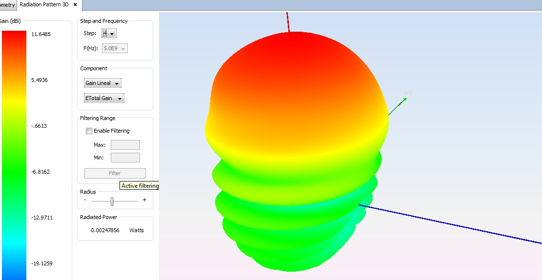

Figure 4. 3D radiation pattern - Step 4: 5.0e9 Hz - Step 5

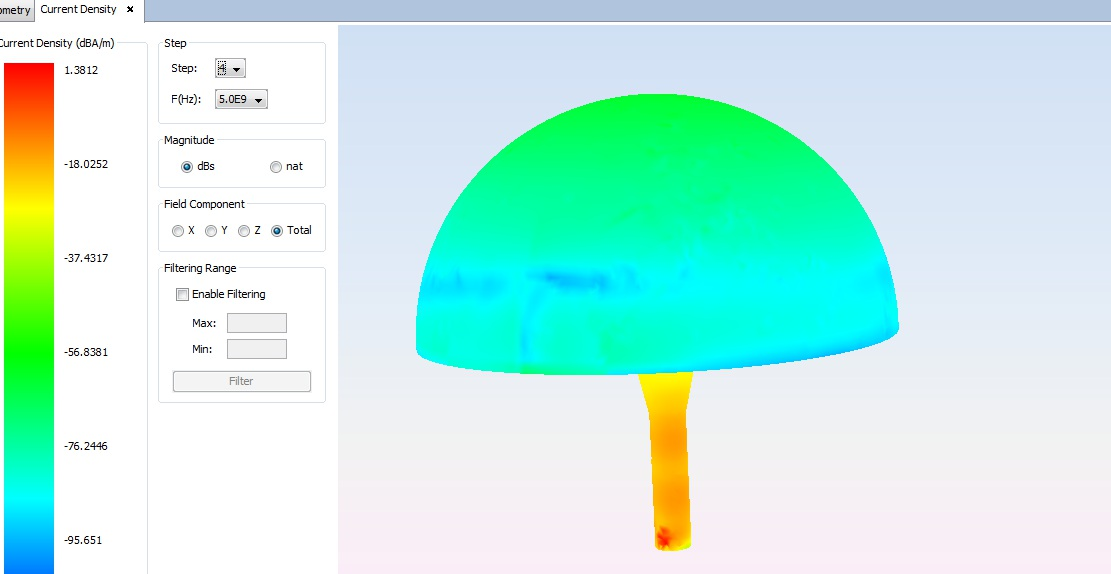

Figure 9. Current density - Step 4: 5.0e9 Hz - Step 5

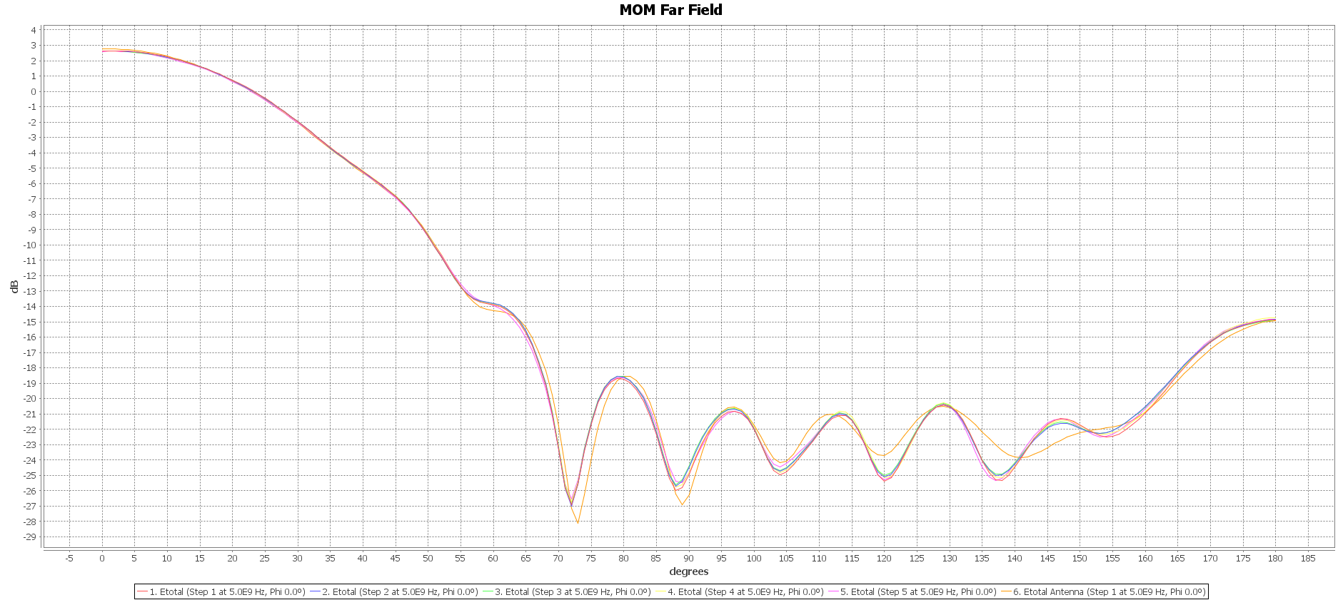

Figure 11. Cut Phi = 0 comparison - radome steps and isolated antenna
