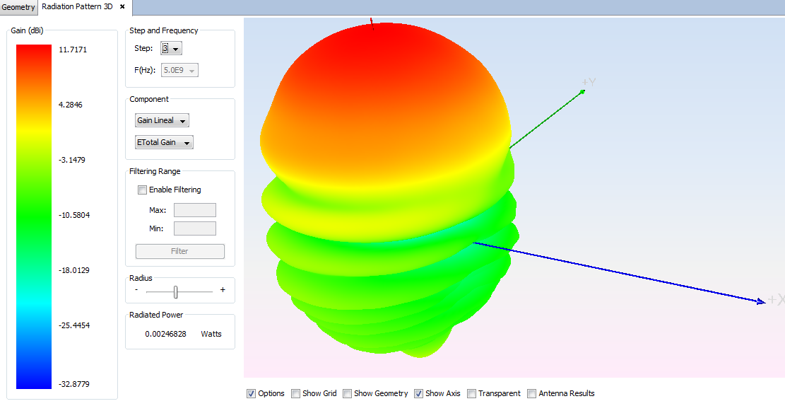

Radiation Pattern
- Step 1
Figure 1. 3D radiation pattern - Step 1: 5.0e9 Hz - Step 2
Figure 2. 3D radiation pattern - Step 2: 5.0e9 Hz - Step 3
Figure 3. 3D radiation pattern - Step 3: 5.0e9 Hz - Step 4
Figure 4. 3D radiation pattern - Step 4: 5.0e9 Hz - Step 5
Figure 5. 3D radiation pattern - Step 5: 5.0e9 Hz

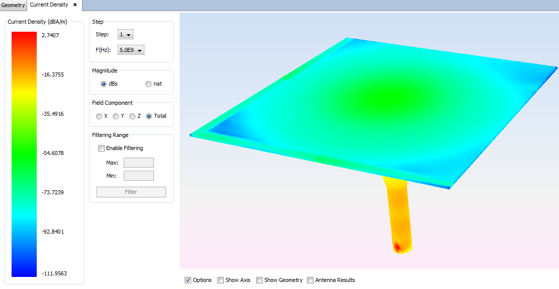

Current Density
- Step 1

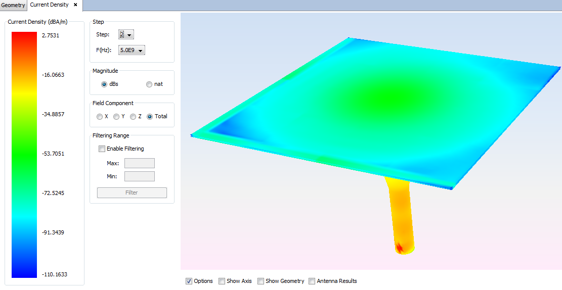

Figure 6. Current density - Step 1: 5.0e9 Hz - Step 2

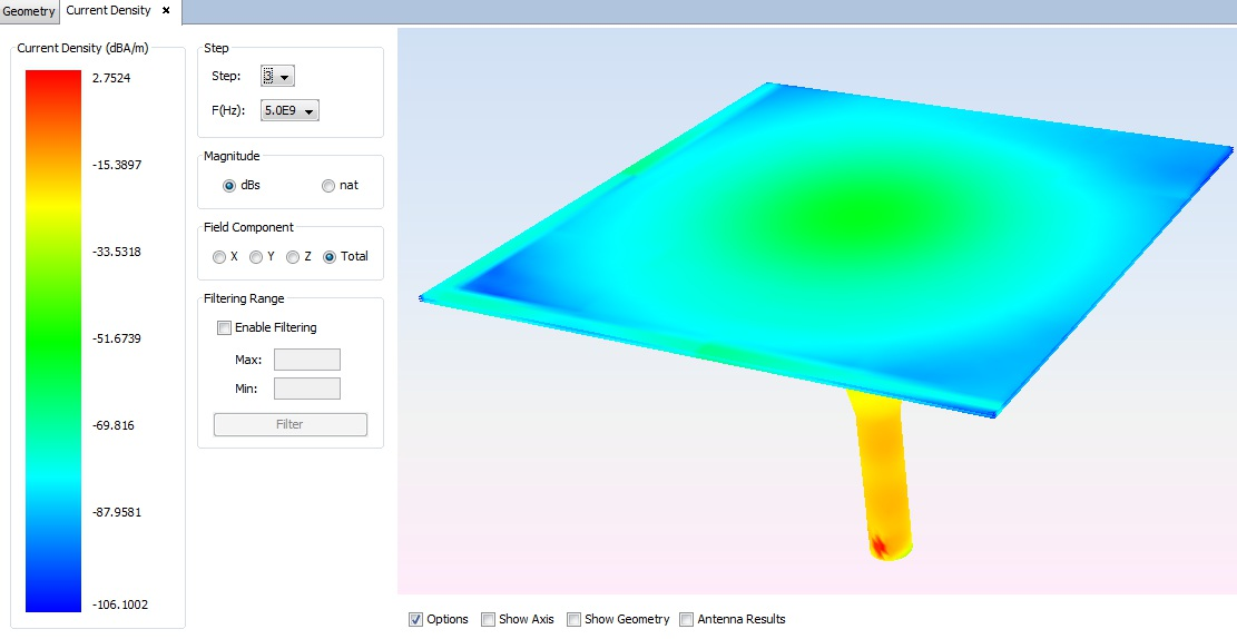

Figure 7. Current density - Step 2: 5.0e9 Hz - Step 3
Figure 8. Current density - Step 3: 5.0e9 Hz - Step 4

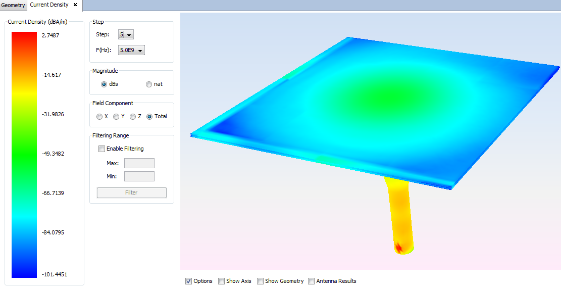

Figure 9. Current density - Step 4: 5.0e9 Hz - Step 5
Figure 10. Current density - Step 5: 5.0e9 Hz

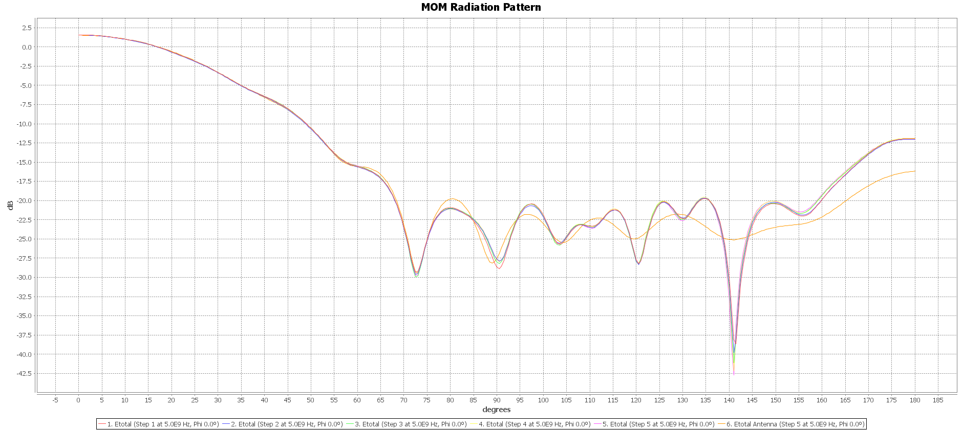

Step | 1 | 2 | 3 | 4 | 5 |
Insertion Losses (dB) |
-0.006747 | -0.028946 | -0.000466 | 0.005269 | 0.007828 |
Radiated Power – Antenna (RPA) (Watts) |
0.00263137 | ||||
Radiated Power with radome (RPR) (Watts) |
0.00246143 | 0.0024529 | 0.00246828 | 0.00245143 | 0.00246245 |
RPA/RPR (dB) | 0.579888591 | 0.61004152 | 0.5557499 | 0.61524845 | 0.57628996 |
Figure 11. Cut Phi = 0 comparison - radome steps and isolated antenna
