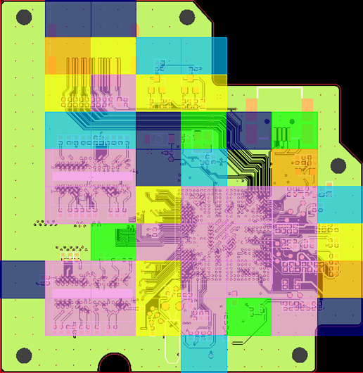

Distribution
Distribution provides the visual display, where and how many extracted JIG data are in the PCB design.
From the menu bar of Test-Point Location Generator, click .
- GRID: Specify the number of grids to display along to the X/Y axis.
- RANGE: Specify the number of JIG data to display in each GRID. The range in the Result section is automatically determined based on the number in the specified range.
- Layer Type: Select the target layer. Depending on the number of JIG data, a different color displays.
- TOP: Check only the TOP layer.
- BOTTOM: Check only the BOTTOM layer.
- ALL: Check both the TOP and BOTTOM layers.
- DELTA: Check the difference between the TOP and BOTTOM.
- User Defined Area: Specify the region manually. PollEx 2022 User Guide Test-Point Location Generator p.17 Proprietary Information of Altair Engineering.
- Result: Set the display color according to the number of JIG data for the divided regions.
- Opacity:
Set the result range color for the grid.
