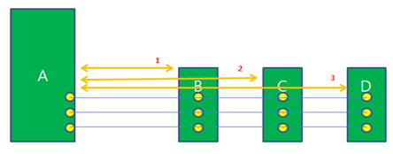

- Combination Length: In case of daisy-chain topology multi-load
system, it checks if trace length of all possible path longer than
Shortest net length + ⑦. It will check trace length of path 1, 2 and
3 respectively.
Figure 1. - Combination Length2: In case of tree topology multi-load system, it

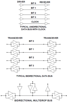

The common clock interface method sends data sync to the driver’s own clock and receives data sync to the receiver’s own clock.
Parallel Bus
- Personal Computer Interface of PCI bus
- SCSI or Small Computer Systems Interface bus
- Compact PCI bus
- VME bus used in instrumentation
- Rambus interface
Serial Bus Examples
- LVDS
- Low Voltage Differential Signaling first devised to allow data transfer from laptop mother boards to flat panel displays.
- Fiber Channel
- A differential signaling protocol used to connect disc drive arrays together. Data rates as high as 1 gigabit per second is possible.
- Infiniband
- A full duplex differential signaling protocol intended to replace the
PCI bus in PCs and servers. Data rates as high as 2.5 gigabits per
second are possible.
Figure 4.
