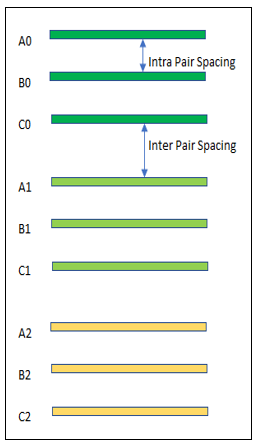

- Intra-Pair Spacing (Min): Allowable minimum spacing between net.
- Inter-Pair Spacing (Min): Allowable minimum spacing between pair.
- Intra-Pair Skew(Max): Allowable maximum length skew between net.
- Inter-Pair Skew(Max): Allowable maximum length skew between pair.
Figure 1. - H-Shield Check: Option for horizontal shield check.
