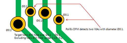

If specified via hole sizes are not in the given ranges, PollEx DFM defines them as fails.
- Target Object Definition: Set target vias that you want to find out in the
design.
Figure 1.- Through Via Drill Hole: Set the through via drill hole size minimum value.
- Blind Via Drill Hole: Set the blind via drill hole size minimum value.
- Buried Via Drill Hole: Set the buried via drill hole size minimum value.
- Exclude Checking for Via Hole Size in Ranges: Among via holes defined in the
table, exclude checking for vias that have hole sizes in the ranges of the
table setting.

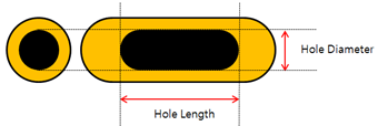

Figure 2.- Item: Specify the item name.
- Min Diameter: Set the via hole minimum hole diameter to be excluded in checking.
- Max Diameter: Set the via hole maximum hole diameter to be excluded in checking.
- Min Length: Set the via hole minimum hole length to be excluded in checking.
- Max Length: Set the via hole maximum hole length to be excluded in checking.
