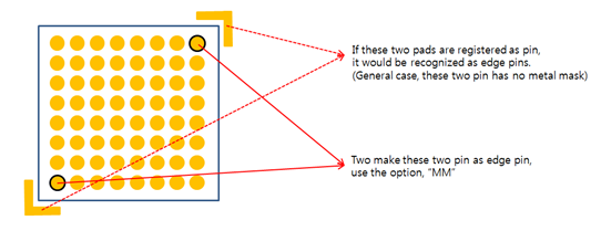

- MM: To avoid PollEx DFM recognizing the
wrong edge pin, use this option so that PollEx DFM will not treat pins that have no
metal mask as edge pins.
Figure 1. - Copper Existence: Checks whether copper exists between the edge pad
