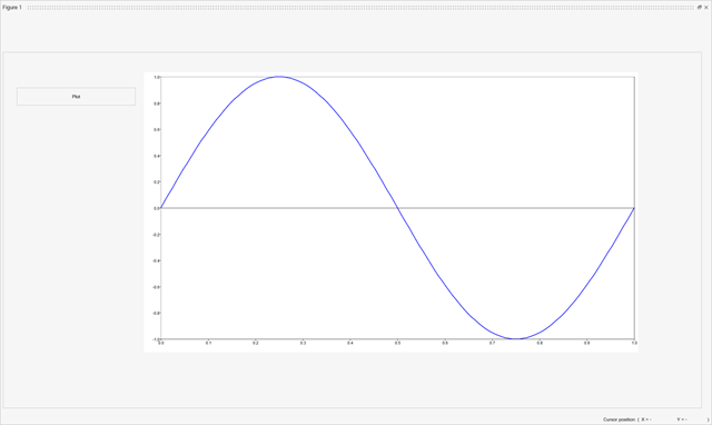

f = figure('units','normalized','position',[0 0 0.9 0.9]);
panel1 = uipanel(f,'units','normalized','position',[0 0.1 0.99 0.89]);
axes('units', 'normalized', 'position', [0.2 0.15 0.7 0.7]);
button_handle = uicontrol(panel1,'style','pushbutton','units','normalized', ...
'position',[0.02 0.1 0.17 0.05],'string','Plot',...
'callback',@plot_function);
The code example produces a GUI that displays the following sin curve when the
Plot button is clicked:
