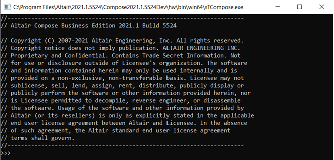

Run Compose in Console Mode
Opening Compose in Console mode provides a shell where Compose OML language commands can be entered at the prompt.
| For this setup | Do the following |
| Windows PC | Invoke the Compose Console via All Programs > Altair 2023 > Compose 2023 Console. |
| DOS Prompt on a PC | Run the following command: <install dir>\Compose_Console.bat or this command: <install dir>\hwx\bin\win64\ExecWinEnvComp.exe -cfg -kc -ef Comp.env -aa 0 -ex ExecMainComp.exe –toolbox -continue |
| Linux Shell | <install dir>/scripts/Compose_Console |
You can run the Console application without arguments to open it.
In this mode, all OML Language features are exposed. However, every command related to the graphic windows (plotting, GUI, readvectorbuilder, and so on) is ignored.

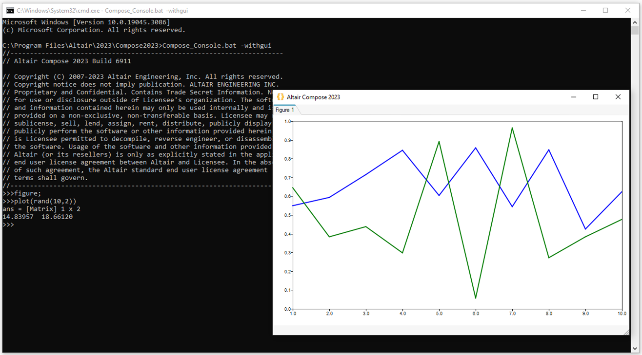

You can use the -withgui argument to enable the plotting and
GUI commands.
