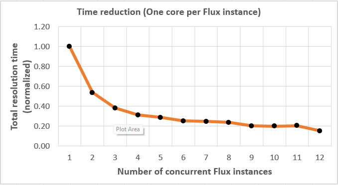

| Parametric Distribution in Flux Skew |
In version 2023, parametric distribution becomes available for all applications in Flux Skew. This feature, which was already available for the other modules, enables users to solve projects faster by running multiple Flux instances simultaneously and by taking advantage of an optimal number of processor cores. Remark that the distribution of geometrical parameters is not yet possible in Flux Skew, but now users may speedup their resolution times when solving scenarios with Physical and Mechanical Set parameters. The picture below shows the time reduction observed in Flux Skew for a project representing an inducton machine and containing three Physical parameters (Bar resistivity, Voltage RMS and Slip), leading to 36 parametric steps. ![]() |
