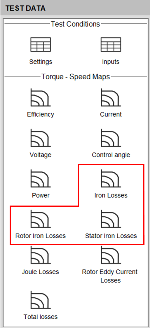

Before FEMT 2023, only the map of Total Iron losses was displayed.

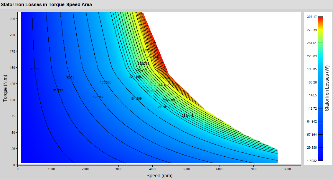

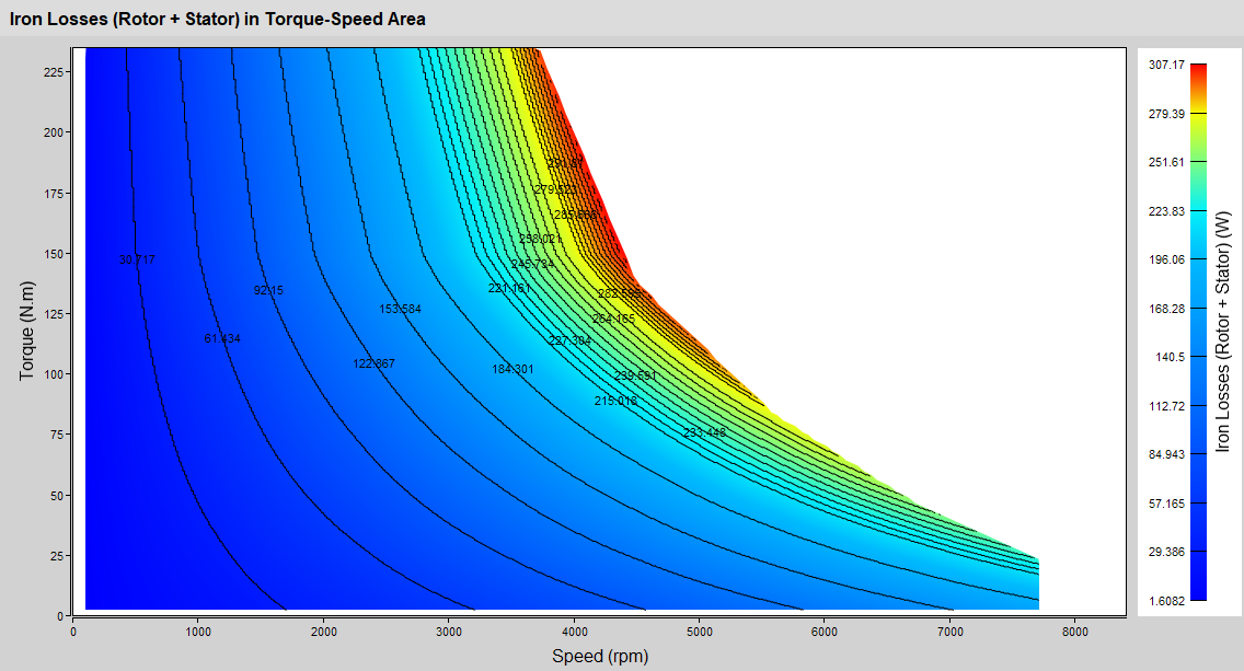

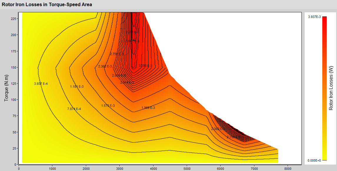

Starting from FEMT 2023 release, there are three maps computed and displayed:- Rotor Iron Losses
- Stator Iron Losses
- Total Iron Losses (Rotor + Stator)
New Maps
| Data Panel | Iron Losses map | |
Rotor + Stator |
| Rotor | ![]() |
| Stator | ![]() |

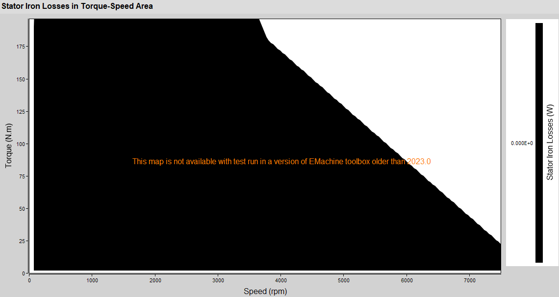

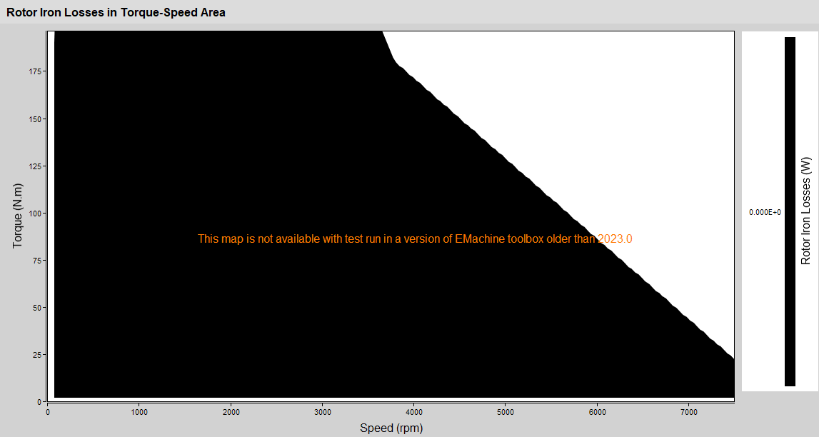

- For FEMT projects computed with a release before FEMT 2023, in FEMT 2023 the
separation of iron losses (rotor and stator) is not computed. So no rotor
iron losses map or stator iron losses map is computed, only the global map
is displayed (rotor + stator iron losses). In this case, the rotor and
stator iron losses maps are black.
Black Rotor Iron Losses map Black Stator Iron Losses map
