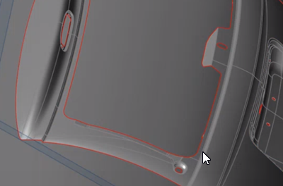

| Select all free edges for drawbead by default | Enable this option to automatically highlight all free edges so
that you can easily select them when creating drawbeads. ![]() |

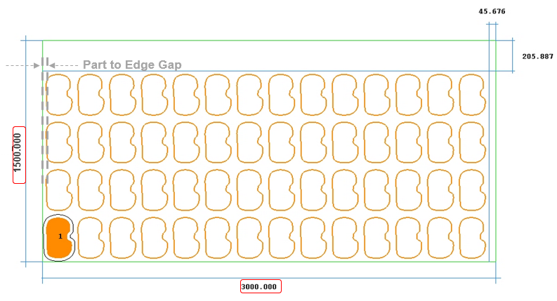

Blank Nesting
| Preference | Description |
Enter a value.![]() Note: If no value is entered, the coil
width and pitch are optimized for maximum material
utilization.
Enter a value.![]() Note: Sheet width and length are
required for nesting on a given sheet stock.
| Top # of Results | Top number of results to published in the report. |
| Export nested layout in .dxf file format | Set the export format to .dxf. |
