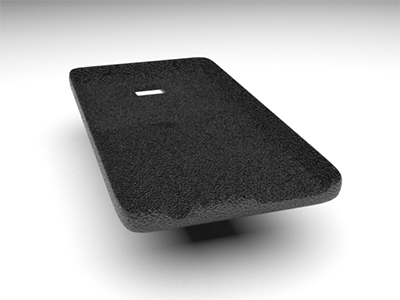

- Coating
- Create varnishes and paints on a layered material.
The coating will reflect some light, while the rest of the light will be absorbed by the layer of material underneath; the extent to which this happens affects how the final material looks.
Several coatings may be applied one after the other, simulating multiple varnishes and paints.
Figure 1. Plastic without a Coating
Figure 2. Plastic with a Coating - Scratches

- Coating
Figure 11. Plastic without a Coating
Figure 12. Plastic with a Coating - Scratches
